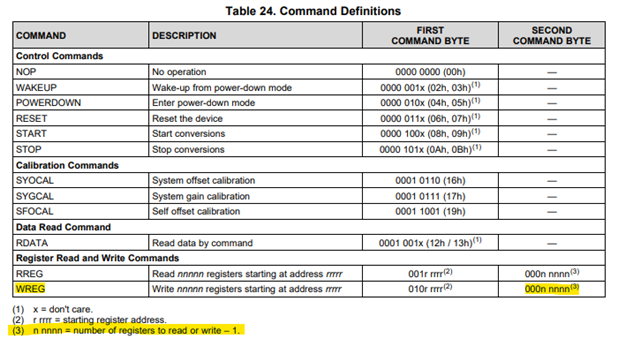

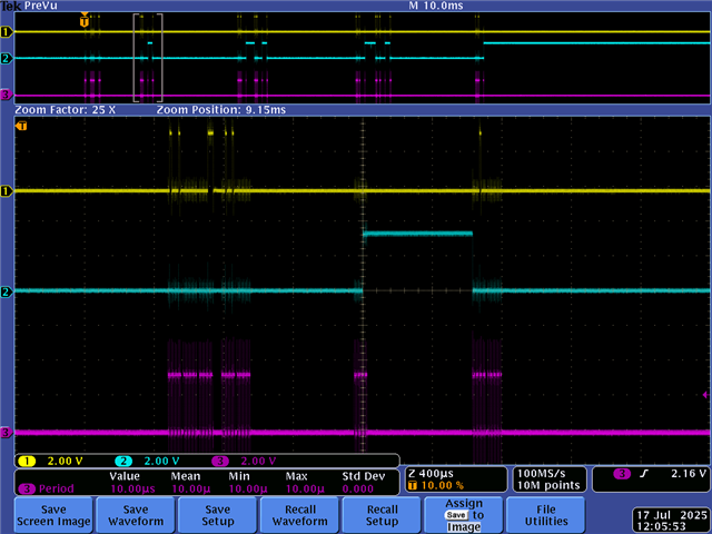

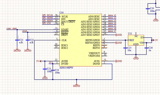

Dear support team,
I am currently developing a test system where I am using 4 ADC´s to convert the measured voltage of shunt resistors. The ADS1148 is communicating with a Raspberry Pi via SPI. I use 4.096V as Vref.
My 1.problem: I think my SPI communication is right and I already measured the communication (picture appended) but no matter which voltage I put on an input pin, the Raspberry Pi reads = or 0.0005V (something like this).
I also read read the dos and donts in the data sheets and saw that maybe my supply is wrong for measuring with Ground but I also tested to measure AIN0 and AIN6 where AIN0 is at 2V and AIN6 is at 200 mV. So the Supply of GND and 5V shouldn´t be a problem.
I will also attache my Code which i am using for testing the ADC. (Sorry for the confusing structure, I changed a lot during testing Slight smile)
ps: If you find something else that is wrong, feel free to tell me.
Thank you for your help and kind Regards!

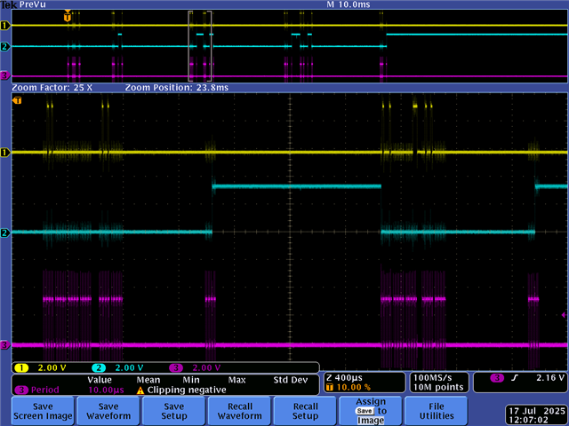

picture of where I send the command to send the data of the ADC:
picture of where I select the MUX:
my schematic of the ADS1148:
  • Hi Jannik,
    Welcome to E2E!
    Are you making single-ended or differential measurements? I saw in your code that the PGA is bypassed
    In f_READ_SPI(), I noticed that you're reading 3 bytes of data. Are you using the CRC or STATUS bytes? I don't see them enabled in your code.
    Additionally, on line 424 in f_read_adc_channel(), I see that you're dividing the output of f_READ_SPI() by 2^23. Since this is a 16-bit ADC, you should be dividing by 2^15. This may be why your Pi is reporting a value close to zero.
    Unrelated, I noticed on line 486 you're defining the 2nd WREG byte for initializing the ADC. If you are only writing to registers 03h-07h, then you should have:
    g_tx[1] = 0x04;   // Anzahl Register: 4 Register (0x03 bis 0x07)
    Maggie

  • Hi Jannik Hinz,
    Do you have a logic analyzer to probe the digital communication instead of a scope? I cannot really tell what is happening in your scope captures e.g. where the transitions occur, etc. If you must use a scope, please label each signal and provide zoomed in, annotated versions of your captures so we can clearly see what is being sent to and received from the ADC. Please include CS, SCLK, DIN, and DOUT

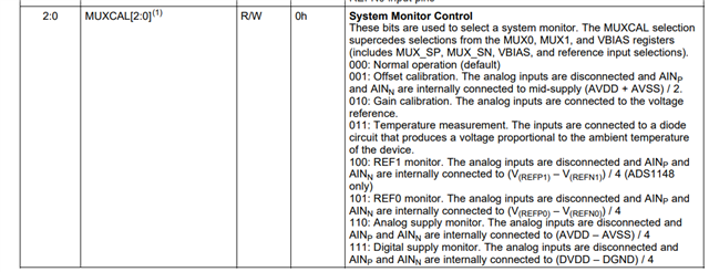

    Have you confirmed that you can successfully write registers by reading each register back after the write to confirm they are correct?
    If yes, can you write to the MUXCAL register (image below) and change to one of the system monitors e.g. AVDD readback or DVDD readback. If you can measure these values then you know the ADC is working correctly and there is some issue with the configuration for your measurement
    You should add a weak pull-up to DVDD on the RESET pin to ensure the ADC starts in a known state. Similarly please add a weak pull-up to the START pin since the START pin needs to be high for the ADC to convert as well as to send most commands e.g. WREG, RREG
    -Bryan
