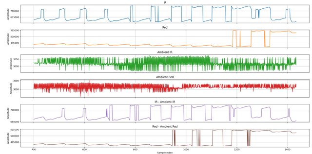

We are using the AFE4490 IC in our customized board and have observed noise on the SpO2 waveform.
When the probe is connected to the EVM board, the waveform looks clean, but when connected to our custom board, the waveform appears noisy.
For your reference, I’ve attached the waveform screenshots.
Kindly review and provide your suggestions to resolve this issue.
EVM Board with ST Board(Same probe):
Customized Board with ST Board(Same probe):

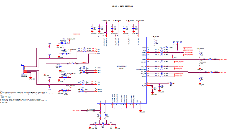

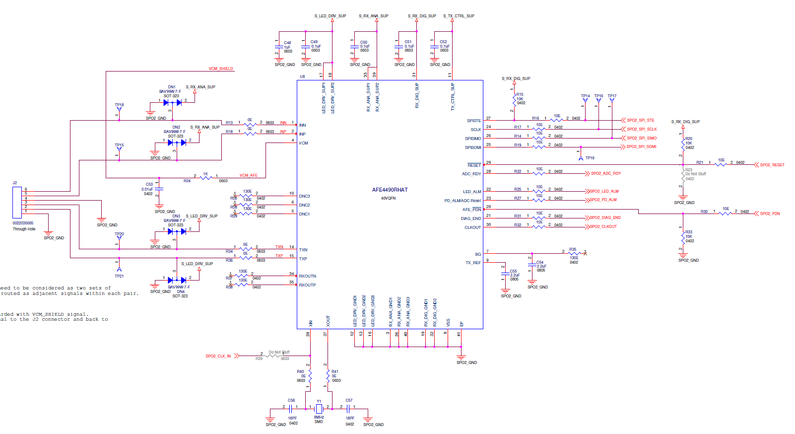

    2) Would you be willing to share the schematic for your custom board?

    2. Attaching the image of the schematic for your reference.

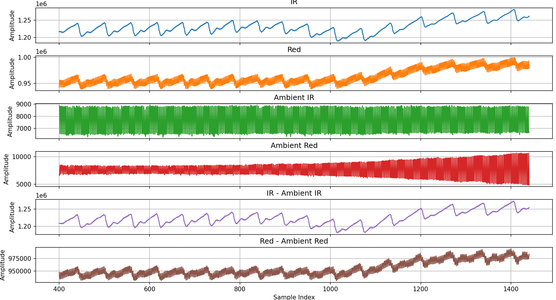

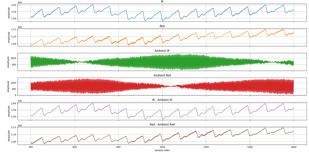

  • Hi Team,
    We have connected both our customized board and the EVM board to the Variscite i.MX8M Mini board and tested them using the same probe.
    The noise levels observed on both the custom board and the EVM board appear to be similar. Is the waveforms are correct?
    Attached are the waveforms for your reference.
    EVM Board with imx8M Mini board(using same probe):
    Custom Board with imx8M Mini board(using same probe):
    Kindly give your suggestions to resolve the issue.
    Thanks!
  • Hello Sneha,
    I apologize for the delay.
    The schematic you sent, while blurry, doesn't show anything of concern, and the waveforms look reasonable. However, it looks like noise may be being coupled to the PPG signal, which is especially visible in the "Red" LED data.
    1) What register configuration settings are you using?
    2) Are you using any filtering to account for power line noise coupling to the system?
    Payton

    Attaching the schematics for your reference.

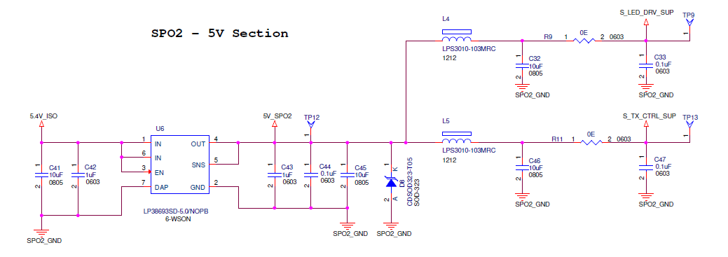

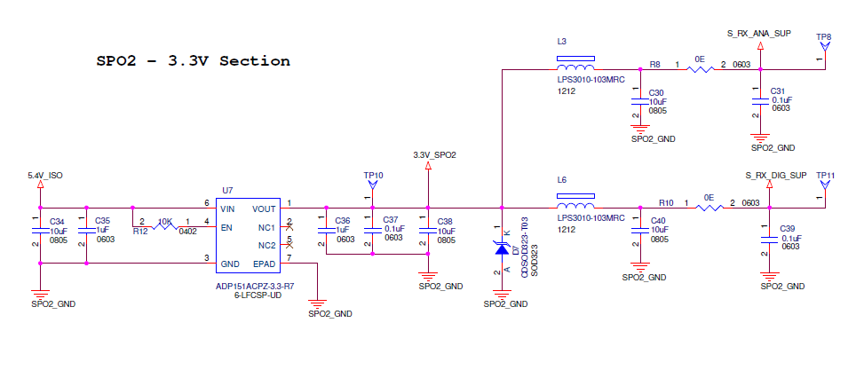

    2. Are you using any filtering to account for power line noise coupling to the system? No. Attaching the power section for your reference.

  • Hi Sneha,
    Your waveforms look correct to me. It does look like there is some 50/60Hz noise coupling into the PPG waveform -- this noise is from the power line frequency of surrounding power, like wall outlets and major electronics that operate at that frequency. This noise can be filtered out with a 50/60Hz notch filter.
    Payton

  • Hi Sneha,
    The notch filter can be implemented in either software or hardware. We do not have an existing notch filter design for the AFE4490, but would be happy to review your schematic if you choose to implement the filter in hardware. Additionally, can you determine whether the noise is coming from the SpO2 cable connection or the AFE4490 circuitry itself? Disconnect the sensor cable from the AFE4490, and see if the data still has a 50Hz/60Hz tone. If that's the case, then instead of implementing a hardware/software filter, you should be able to eliminate the 50Hz/60Hz tone by shielding the cable depending on what works best for your application.
    Payton
  • Hi Payton,
    If we removed the sensor cable from AFE4490 EVM board or customized board, we get the constant data.
  • Hi Sneha,
    If the constant data seen when the sensor is disconnected does not have a 50/60Hz tone, then the noise in the data is likely coming from the sensor and the sensor cable. Shielding the cable should improve the signal output. Additional suggestions can be found here.
