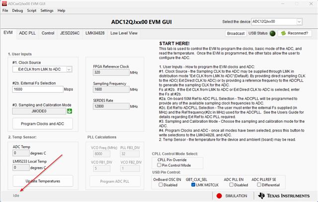

We are using the tool to configure the part with:
83.968MHz differential input clock,
671.744MHz sampling clock,
JMODE 4,
11083.766Mbps serial lane rate.
TRIGOUT to be serial rate/64 = 173.184MHz
The file we obtain from the tool is below.
We are having difficulty getting it programmed successfully. Parts of it are getting programmed, PLLREFLO outputs correct signal, and we can read back registers. But TRIGOUT is wrong frequency.
Is there a way to verify the sequence the registers need to be written, including delays?
We have enabled sending log to file, but we cannot find where the tool is sending the log file.
