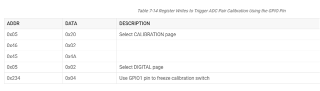

Regarding the GPIO configuration for the ADC32RF55, I would like to set it up as described in Table 7-14 of section 7.3.4.3 to calibrate 2 ADC pairs at a time using a GPIO trigger.
However, the timing for this configuration is not specified in section 8.3, Initialization Set Up.
When should this configuration be implemented?
