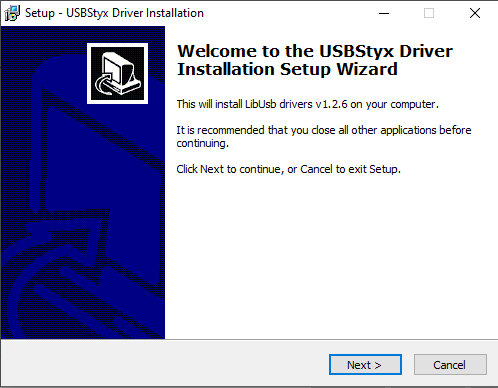

Hi ! I can not install SW for ADS1198ECGFE-PDK evaluation board, please see below.
Windows 10, I tried at 2 different computers.
Waiting your advice.

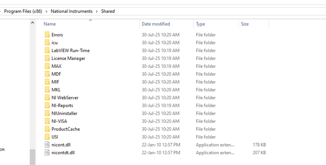

Hi Ryan! Please find below a screenshot of the files in C:\Program Files (x86)\National Instruments folder.
Please let me know if you need more information.

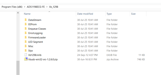

Can you also check the following directory: C:\Program Files (x86)\ADS1198ECG-FE\lib_1298? This is where the subVI's should be located if the USBStyx drivers are installed correctly. Make sure that you have Administrator privileges so that these directories can be written to:
Ryan
Hi Ryan!
Please find attached the requested directory content. I do have administrator privileges.

Hi Vladimir,
Thanks for checking the files. They do seem to have installed correctly.

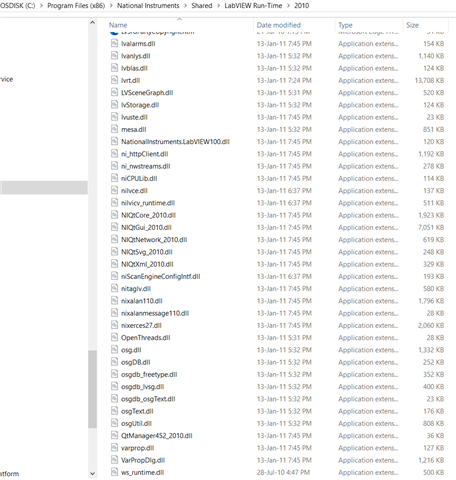

My best advice is to review the version of NI LabVIEW Run-time Engine you have installed. Can you check which versions you have in C:\Program Files (x86)\National Instruments\Shared?
Ryan
Hi Ryan.
Please find attached the run-time folder content.
Hope this will help.
Vladimir
