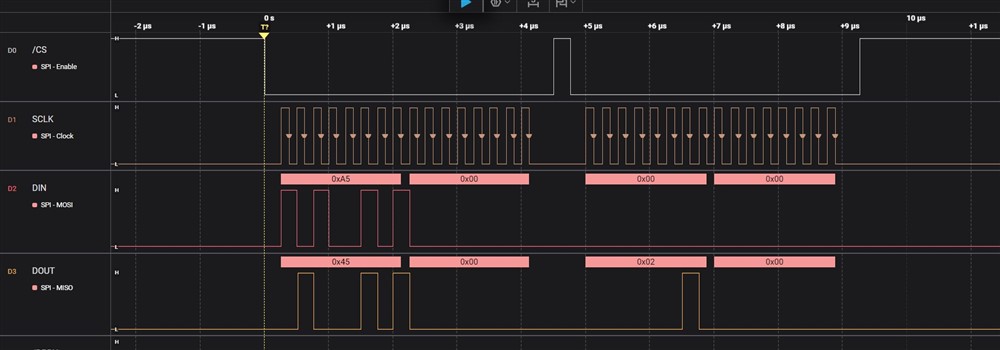

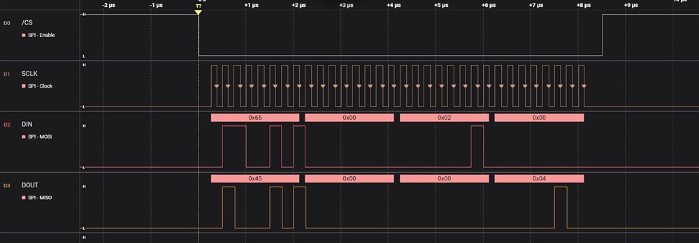

  • Hi Baskar R,
    You should be able to write or read a register in 16-bit word size, the following timing is an example to write and read CH0_OCAL_MSB register in 16-bit word size:
    Write CH0_OCAL_MSB register with 0x0200:
    Read CH0_OCAL_MSB register:
    BR,
    Dale
