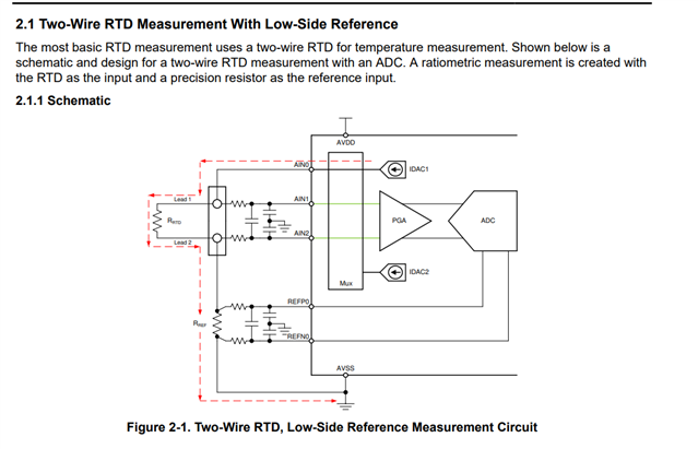

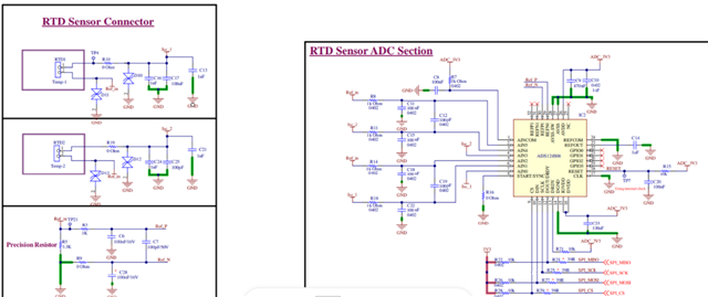

Hello I am using this configuration but I want to use this for two RTD,but it has only one Refp0 and Refn0,but i want to use another RTD so how can i use reference two reference can i use another RTD in series.Is that method is correct .Suggest possible solution for that.
Or i have to use voltage measurement method when i am using two RTD measurement using ADS124s06.

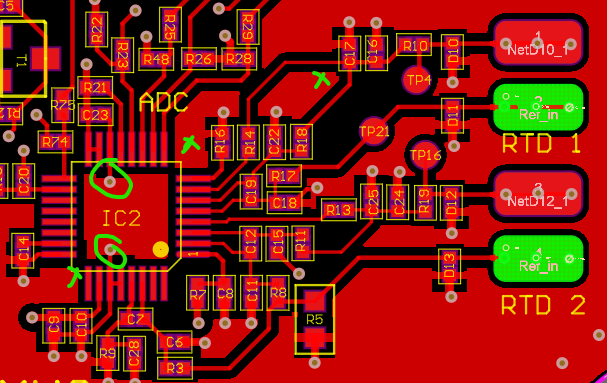

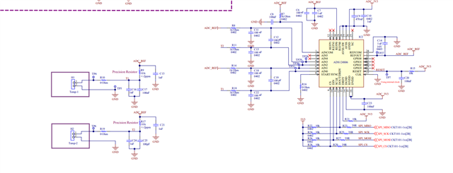

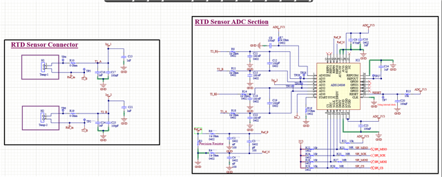

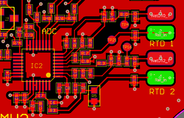

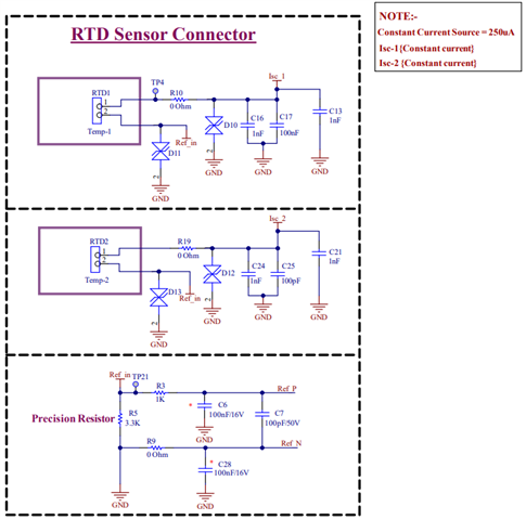

I am using this circuit for my application .Review my Circuit and suggest possible changes .I am concern about the rtd 1 point T1_B and RTD 2 point T2_B become short every time is it create in accuracy in measurement while doing measurrements.So suggest the possible resolution of my concern.

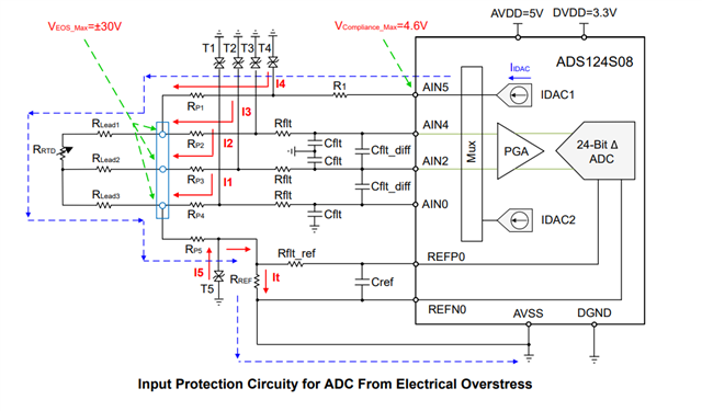

i need to use all this for ESD protection of 12 kv or not.Also wants to know Refout pin and AINCOM Pin where is to be connected for my application.
This is my final circuit with TVS diode of 5.5 V and Please review the Design and Suggest possible changes and feedback.I also have some query regarding that the cutoff frequency of differential mode across RTD and Ref need to same.If i have took differential Cutoff frequency than i have to select different value for RTD and Ref pins Input. I did some calculation for 10 khz cutoff of common mode and please review the calculation ,also is there need to tune differential cutoff frequency for RTD and Reference
