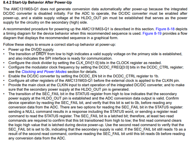

we had trouble initializing the AMC130M02 according the procedure described in datasheet.
We should:
  • disable the CLKIN signal
  • do a long pulse on reset
  • wait for DRDY to become high
  • configure registers
  • enable CLKIN signal

  • Hi Tomas,
    Is this initialization you are doing on initial start-up of the device, or after resetting the device?
    On first time start-up you should do the following:
    In this case, once DVDD is stable the DRDY pin should go high.
    If you are resetting the device through a SPI write or the RESET pin, you will need the CLKIN signal to stay enabled.  The reset is timed with the CLKIN signal, so it needs to stay enabled to understand the command and control the DRDY signal. (note:  The DRDY signal may toggle several times while the reset is occurring.  You should verify the reset status with the Status register).

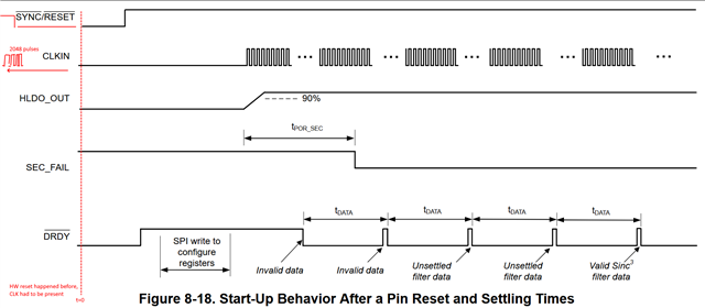

  • Hello Ahmad,
    In the DS chapter 8.4.3 figure 8-18 it is clearly visible, that even in case soft reset triggered by pin reset or reset command, the CLKIN signal should not be present. Could you please confirm then, that this is a mistake in datasheet and you are going to correct it?

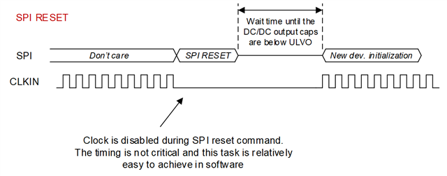

    Software reset
    SW reset happens over SPI command and DOES NOT use the CLKIN clock domain. The CLKIN shall be disabled before sending this command (to be explained later).
    Hardware reset
    The Figure 8-18 in AMC131M02 datasheet somehow indicates that the clock is not present during the reset. However, this figure shows rather "after reset" condition. See my hand-made modification.
    It is important, that during the HW reset, the clock stops after 2048 pulses, worst case, 2048pulses + 5us.

    From your explanation about the reset sequence my conclusion is that it is easier to use software reset using SPI command and not the SYNC/RESET pin.
    Ivo
  • Hello Ivo,
    Your understanding is correct. The software reset sequence is safer as the timing remains always the same and the analog inputs side (secondary side) of the isolated device never enters this ultra low Iq mode (tens of nA of consumption).
