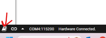

The screen looks like the picture below.
How can I change it to look like the user guide?
Thank you,
  • The hardware connection is successful and the connection status is green.
  • Hi Tango Sota,
    Do you get any error messages or pop-ups when you turn on the GUI? If yes, can you please provide screenshots of them?
    Is there anything in the log file (click the icon shown in the image below)? If yes, can you please provide it?
    Make sure that the EVM is connected to your PC directly, not through a USB hub for example. Then turn on the GUI
    -Bryan

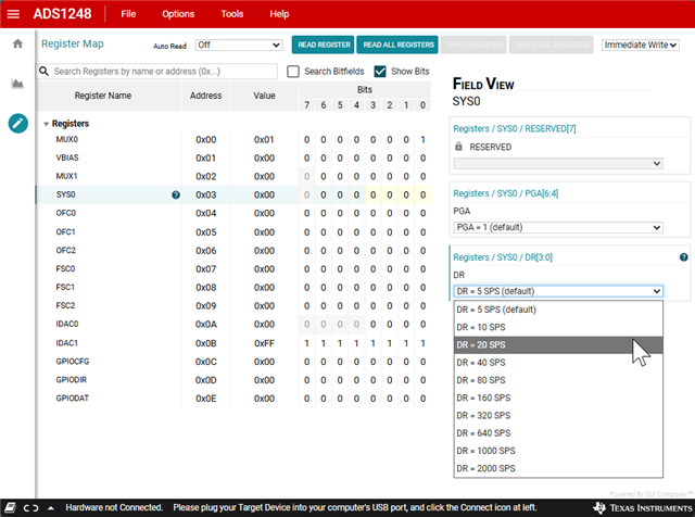

  • Hi Tango,
    Thanks for making us aware of this issue! It might take us a little time to circle back around to this and implement the fix; however, please know that the side menu controls are just aliases to controls inside of the device register map page. Hence, please ignore the Capture Settings menu for now and use the "Register Map" tab to access these settings directly.
    • Data rate is controlled via the DR field in the SYS0 register
    • The positive and negative mux inputs are controlled via the SUX_SP and MUX_SN fields in the MUX0 register
    • The PGA gain can be set via the PGA field in the SYS0 register
