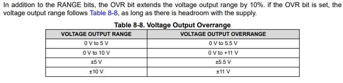

    To get an output value greater than 5V you can still use a higher range and calibrate it lower. Instead of using the 0-5V output range, you can set it to the 0-5V range and use the 10% overrange and then set the calibration to a value a little smaller than the 5/5.5 proportion to get a value that is approximately 5V output. You could also set the range to 0-10V and calibrate it to something close to 1/2. You would lose some resolution, but that would happen through calibration anyway.

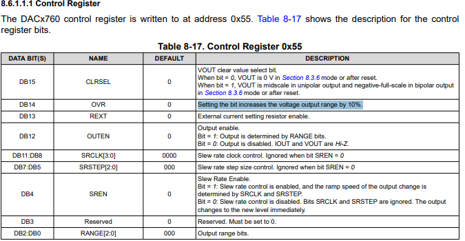

    Second, you still should be able to reach the output by using the 10% overrange function. Each range 0-5V, 0-10V, ±5V, ±10V all have an overrange function so that you can reach 0-5.5V, 0-11V, ±5.5V, and ±11V.
    You can set this overrange mode with the OVR bit in the control register (address 0x55, DB14).
    If you a little low in voltage, you should be able to set this bit and scale the output back using the gain calibration. This adds +10% of adjustable range, but you should be able to reach your desired full scale.

    Enabling the OVR bit and performing gain calibration allows the voltage output to reach full scale, but the output current is insufficient.

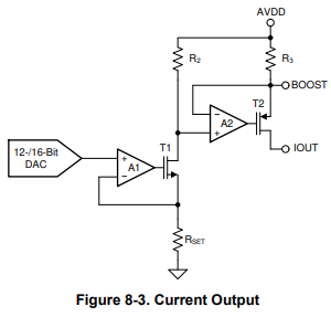

    I'm glad the overrange works for the voltage output. The current output doesn't have a similar overrange. However, you may be able to play with the output range for current in a similar way, but it is a little more complicated. In this setup, you could use the external RSET resistor to set the output current. The current output stage of the DAC is constructed in this way:
    There is a 15kΩ RSET resistor that sets the current output of the DAC. In most cases you would use an internal RSET for the current. However, you could use an external RSET to change the gain. This can be set from Bit 13 in the Control Register. If the current is a little low, a slightly lower resistance would increase the output current. Note that the current scales with this resistance and that any drift in the resistance would be seen as drift in the current.
    I haven't used an external RSET in anything I've worked on, so I'm not sure how the device generates the 4mA current in the 4-20mA current mode. If the 4mA is a pedestal current added to the output current DAC, then the 4mA offset current in the 4-20mA mode might not be adjustable.
