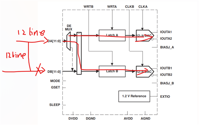

Customer want to lower the used IO number in DAC5662.
Hence, they want to connect the two set of input into DA0-11 like time interleave method. The combined the DB group IO line into the DA, which is 24 line in DA group. In same time only will have 12 line with data and output Iout1, and next period will have another 12 lines have data and output to Iout2.
We want to know if DAC5662 support that usage?

  • Hi Yishan,
    Both dual and single bus interleaved methods supported by the device are listed in the datasheet on pages 15 and 16 respectfully.
    If the customer plans to deviate from the datasheet recommendations, we cannot support.
