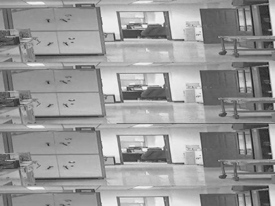

Dear,
We use TVP5150AM1 for PAL -> BT656 decoder for our ARM9 embedded system. During the doing my project , I get the CVBS input into the AIPH1A and the input resister and capacitance is only be set to the 37.4 ohm and 0.1uF, the register value is only be set by default too. The YOUT 7 has set a 10K oum rester to pulldown .So this chip work as a slave. Recently we encountered a problem that the video we get from the TVp5150AM1 is black & white . I adjust the register 0X03->0X09,0X00-> 0x00,0X07->0X40,0X0D->0X07, the video is only black & white. By the way the we can get the right value from the register 0x80 , 0x81as the 0x51,0x50.
We check the hardware and software according the TVP5150AM1 pdf file. we can not find any question.
So my questions are,
1. Does the TVP5150Am1 hardware and software which we design have some potentially problemhe during usingTVP5150AM1?
2. Does setting the register CVBS input have some questions?
Unfortunately, we cannot identify which one is not right in my design at now.
