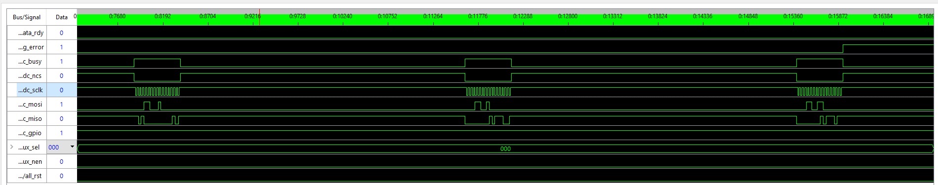

  • It seems my understanding of the datasheet is not correct.
    In manual mode, If I sample the same channel number 8 in all SPI transactions -
    the sampling and conversion and sending is happening on the same transaction.
    and not as I understood from the datasheet - that sending should happen on the next transaction - but apparently I was wrong.
    Same Channel Sample convert and send
    In the picture you can see the logic analyzer's pickup.
    I have an analog MUX connected to channel 8 of the ADC.
    Only MUX input number 4 is connect to VCC to get FFF reading. All other external MUX inputs are connected to GND to give 000.
    I sample channel 8 of the ADC while MUX is on 3 to get 000 -> then I sample channel 8 another 2 times on MUX on channel 4 & get FFF twice ->
    Then other MUX inputs...
    There is NO delay of one SPI transaction - the voltage is converted and sent in the same transaction - NOT as could be understood from the datasheet.
    What do I miss?
    Thank you.
    David.

  • As explained - and you can see in the timing diagram - the channel selected is 8 - and channel received is 8 - in all transactions!
    My external MUX has its 3 select bits in the diagram and all inputs connected to GND except 4 which is connected to VCC.
    As you can see - there is no delay - the result of the conversion is sent immediately at the same transaction as the sampled.
    I get FFF on selecting external MUX to 4 in the two middle transactions... and 000 in all other channels.
  • Hi David,
    Apologies. I misunderstood the setup. I've read more carefully this time.
    The internal ADC MUX is set to channel 8. You also have an external MUX connected to channel 8. On the external MUX, input 4 is is connected to VCC (full-scale), while the other inputs are grounded.
    The behavior you are seeing is expected. The input is sampled and held on the falling edge of ~CS. See the timing diagram below (Figure 1), specifically the acquisition and conversion plots.
    The paragraph below also clarifies the timing. The device outputs data while the conversion is in progress.
    The delay I was referring to is the internal channel switching delay.
    Joel

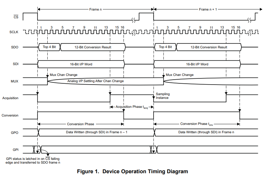

  • Joel
    I do not see in the figure 1. where you see that the data sent is in the n'th transaction is from the same n's CS falling edge.
    If you look at the Acquisition line - you can see that sample starts at clock 13 of n-1 and ends at the falling edge of the n's CS.
    It does not say on the SDO line - to what Conversion, the 12-Bit Conversion Results, belong to - the n's or the (n-1)'s?
    So I looked at Figure 51:
    Here you can see clearly the delay of one sample from conversion i2c transaction to sending i2c transaction - that is not happening in real IC
    If I have "non counterfeit" device :-) in my board...
    Do you have in your dev board the ability to test this?
    Thank you.
    David.
  • Hi David,
    It is the combination (acquisition and conversion) of figure 1 and the text that gives the detail.
    The data on SDO belongs to the sample acquired immediately before the conversion cycle, per the datasheet.
    In your case, you are not sending a command on SDI to change the channel internal to the device, so there is no internal mux switching delay, and figure 51 does not apply.
    So acquisition for the input signal begins on the 14th rising edge of SCLK of frame n, and end when ~CS falls to indicate the start of frame n+1. Conversion for the sample happens at the same time that data on SDO is shifted out.
    Let me know if that helps explain the operation a little more clearly.
    Joel

    How does the chip know what to do after sampling and converting? in one case it sends the data in the same SPI transaction of sampling - and in the other case it sends the sampled data in the next transaction...? ( sampling is happening in start of current transaction CS falling edge... )
    This is very unexpected behavior... since it will find out on what case it is in "in it's past" - channel is selected on bits 10 to 7 and data is sent from bit 11 to 0 :-)
    Can you please fix my behavioral model above... just to be clear on what you mean...
    Thank you!.
    David.
  • Hi David,
    I think to clarify, the device always samples on the falling edge of ~CS for the current input that is selected on the mux. The sampling, conversion, and data output will happen within the same SPI frame.
    However, the internal mux switching itself is delayed, so the ADC will take more samples of the same channel before switching.
    I've linked a post from my colleague below, which might help to clarify further, and I wish I would have thought to phrase it like that earlier. I think the important part is to differentiate the instance the input signal is sampled, and when the mux switches to allow the input signal to be sampled.
     ADS7953: Manual Mode Timing Diagram
    Joel
  • Joel,
    What is clear is that the datasheet is not clear :-)
    Keith's explanation is not helping:
    "Here is the flow as presented in Figure 50:
    (a) Frame n: * SDI : Programming for ‘frame n +1’, DI10..7 = binary address of channel"
    (b) Frame n+1: * Mux : Selects channel programmed in ‘frame n’(Manual mode) this channel will be acquired in this
    frame and sampled at start of ‘frame n+2’"
    NOT used in my case since I use channel 8 always - No change of internal MUX channel.
    "(c) Frame n+2: * Sample: Samples and converts channel selected in ‘frame n+1’"
    I could guess that in this transaction the data sent is of the same transaction's sampling... - not explicitly written.
    The datasheet does not  explain that "sampling converting and sending" are happening on the same transaction.
    It is very easy to mistake the internal mux delay for sampling-converting to sending delay.
    Thank you.
    P.S. I fixed the behavioral model I placed above to reflect my new understanding of the datasheet...
    David.
