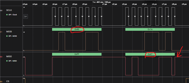

    Can you provide us logic analyzer captures showing the data communication between the ADC and the controller? Please include the CS, DOUT, DIN, SCLK, and DRDY signals. I'd like to see the WREG, RREG, and RDATA commands, as much as you can send me. If you have a Saleae logic analyzer you can send us the .sal file
    Make sure that the plots are labeled so we can clearly understand which signal is which
    -Bryan
  • Hi Bryan,
    I have attached the .sal file capturing details about ADC init and ADC data capture, please review.
    Thanks and regards
    Prashant V Achari
    .ADS1261RTDoutput.zip
  • Hi Prashant Achari,
    Thanks for sharing the requested information
    In your saleae capture you are triggering on the wrong edge (rising, whereas you should be triggering on the falling edge). This is not a problem if it's just the Saleae (the data can be wrong, but that's easy to fix). If your controller is triggering on the wrong edge however that won't work, and the ADC communication will be broken
    You can see this in the image below (note that I switched to triggering on the falling edge) where the value on DIN is not the same as the response on DOUT.
    Can you please make sure you are triggering on the correct edge, otherwise the communication will not always work.
    You can also try enabling the CRC to make sure there are no communication errors
    -Bryan
