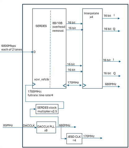

We are transmitting 170Msps x 64 across two JESD lanes as shown below (16 bit I/Q for each of two DAC outputs)
My assumption is that the JESDCLK should be 170MHz (divide by 4, config37=0x4000) as shown below.
However, it must be set to 340MHz (divide by 2, config37=0x2000) to work.
    Please utilize the DAC38J84 Configuration GUI to set the internal JESD204 clock. The internal JESDCLK is set by designer to work most efficiently with the DAC38J84, and may not necessarily be the most intuitive at a block diagram level
    https://dr-download.ti.com/software-development/gui-for-evaluation-module-evm/MD-CG8OTKFiuQ/01.00.00.0C/slac644c.zip
  • We are using the GUI, it asks user to identify this frequency. This clock is internal to the DAC, and used only internally and there is no instruction on what freq to set. Efficiency is not the issue, it works perfectly when set to 340MHz, does not work at all at 170MHz. Since it is called JESD CLK, it seemed logical that it would be running at the rate that data is pulled from the JESD block and delivered to the interpolator. However the block diagram I showed is must my assumption of what the part is doing internally.
    How do I determine, given what I have described, what to set that clock to?

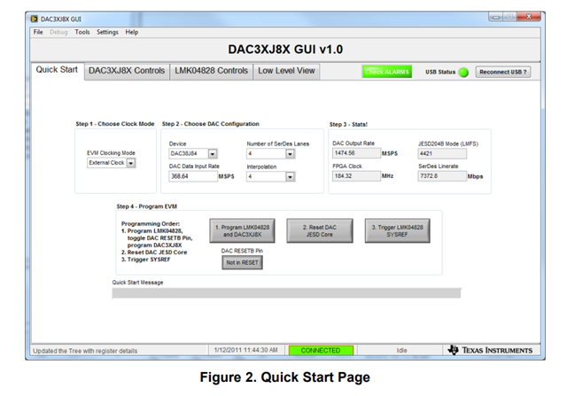

  • Hello David,
    The quick start page, once you enter the needed configuration for the DAC38j84, will automatically configure the JESD CLK for you. The clkjesd_div setting is all calculated.
    Depending on the JESD204B configuration setting of the JESD204B RX logic block, the reference clock to the JESD204B RX logic block will need to be adjusted accordingly. Please refer to Table below for details on the clock divider setting.
    DAC3xJ8x JESD204B RX Logic Clock Divider Setting

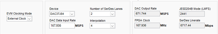

  • Ok, I understand, thanks.
    The Quick Start page assumes that the DACCLK is not translated in freq by the PLL (N divider divides by 2, prescalar multiplies by 2) as shown below.
    I thought I needed to recalculate everything on this page given my lower freq input DACCLK and my SERDES REF derived from PLL Clock.
    However, I needed to recalculate everything *except* the JESDCLK divider.
    Thanks for clearing that up.
