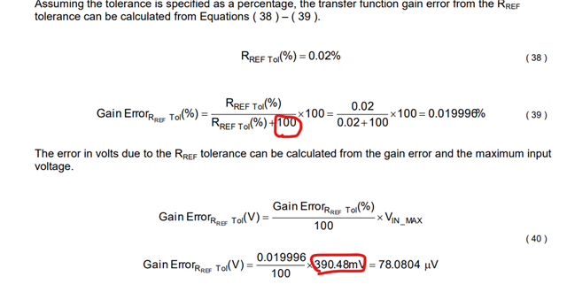

In page 17 of  the document "3-Wire RTD Measurement System Reference Design, -200°C to 850°C",
I have one question on this page.  In the equation (40), why the voltage drop(390.48mV) across RTD is used instead of one across the Rref?
Another question is how to analyze errors when the resistance on leads are not equal.
