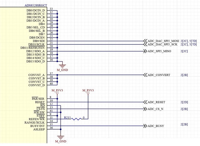

We are using the ADS8528 in HW configuration mode with serial data transfers.
See schematic for SPI connections.
From the datasheet, it appears the ADS8528 channels (CH_A0, CH_A1, CH_B0, CH_B1, CH_C0, CH_C1, CH_D0, CH_D1) are grouped as pairs and the data can be off-loaded serially in pairs via the SDO_A, SDO_B, SDO_C, and SDO_D outputs.  Our design is configured to output all 8 channels serially via the SDO_A output.

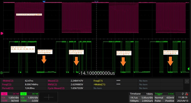

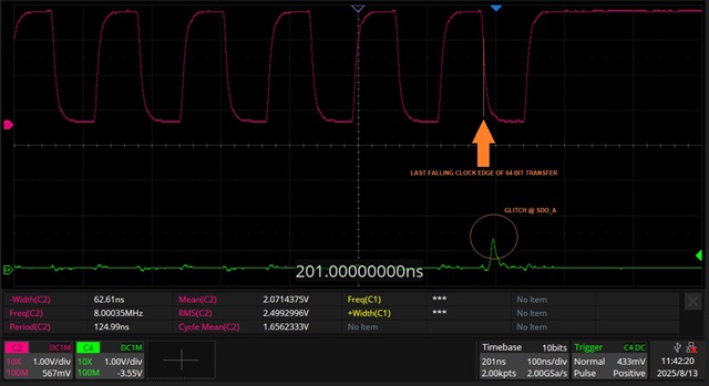

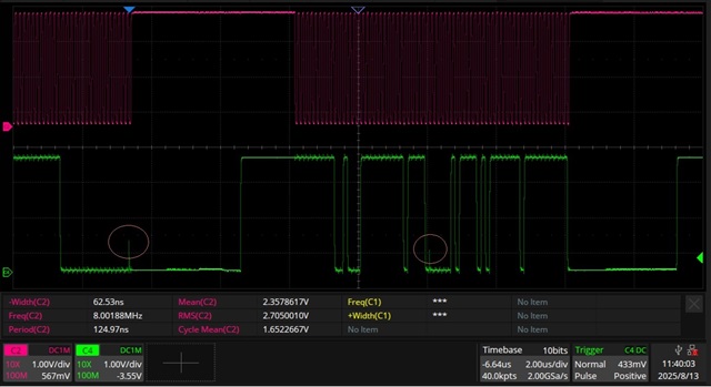

When reading the serial data output, there appears to be a “glitch” at the 32-bit and 64-bit boundary of the data transfer.
I have attached scope plots of the SPI clock and serial data output at SDO_A.  While we are sampling all 8 channels, for this instance, we only read the first four channels (CH_A0, CH_A1, CH_B0, CH_B1).  Therefore, these plots display groups of 64-bit transfers (channels CH_A0, CH_A1, CH_B0, and CH_B1).

    It's been a little while!  Happy to see that you are still working with the ADS8528.  So you've decided to go with the single SDO - did you ever get the 128 bit transfer to work?  I don't recall ever seeing that glitch before - are the actual conversion results as expected otherwise?  The glitch may be an artifact of the internal shift register loading the next data-set into the serial output buffer.  Do you still see it if you speed up the SCLK?

    Our circuit design includes an isolator in the SPI communication path to the ADS8528.  We traced the error to a glitch input to the isolator data line from the ADS8528 data output.  The isolator datasheet mentions a susceptibility to glitches less than 10nsec wide causing latching behavior (up to 4usec) at the isolator output.  The glitch at the end of a 32-bit transfer typically was only seen if the previous bit value was low.  If low, the low to high glitch into the isolator presented as a high value output at the beginning of the next data word for 4usec, causing data corruption into our processor (see attached scope plot).  If the previous bit value was high, the glitch would be obscured by an already high data-line out of the ADS8528.

  • OK - thank you!  You mentioned earlier that there were 'other parts' sharing the SPI bus, can you provide a schematic or tell me what those are?  Also, are you using the A grade or B grade of the isolator chip?
  • Tom,
    The DACs sharing the SPI bus are AD5620CRMZ-2 - these do not have an SDO line.  The ADS8528 SDO is the only MISO line feeding our processor.  We are using the "B" grade isolator.  We have implemented filtering of the serial data line to the isolator to reduce the glitch and alleviate the latching output.  I just wanted to confirm if the ADS8528 could be a source of the glitch we are seeing.
