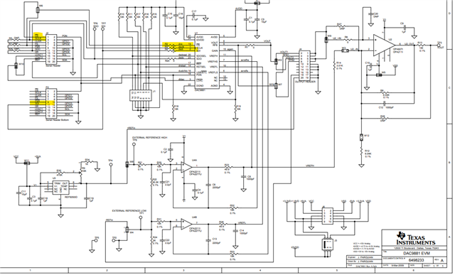

Dear Team,
I am evaluating two TI boards:
1. DAC9881EVM – I want to know whether this board can be directly communicated with using a standard I²C/SPI adapter (such as Aardvark or similar) If yes, could you please share any documentation or examples for the required connections and protocol details?
2. ADS8860EVM – This comes with the PHI controller board.
Can I connect the PHI board to a PC via USB and use the TI GUI for configuration and data capture?
Is it possible to export the captured ADC sample data from the GUI into Excel, or alternatively, access the converted data directly using Python (for example, through an API or by reading a data log file generated by the GUI)?
The ADS8860 datasheet shows SPI pins such as SCLK, CONVST, etc. Does this device support communication with a standard SPI master (without the PHI board) if I want to directly interface it with another microcontroller or SPI adapter?

  • Hi Saikumar,
    1. looping in the DAC team
    2. Yes, the ADC GUI make be used for configuration and data capture. You can right click the plot and export to csv.
      1. You may use this device with other MCUs. You may refer to section 9.4.1.3 of the ADC datasheet.
    3. If you take a large number of samples when capturing ADC data, you should be able to see a few DAC steps. As the GUI does not facilitate true continuous capture, you will need to take a number of captures.
    Samiha
  • Hi Saikumar,
    1. Yes. I do not have additional documentation beyond the DAC datasheet and EVM user's guide. The user's guide (page 20) has a schematic that shows the pinout of the EVM where you would want to connect the external controller SPI signals to the EVM. The protocol details are in the device datasheet.
    Katlynne Jones
