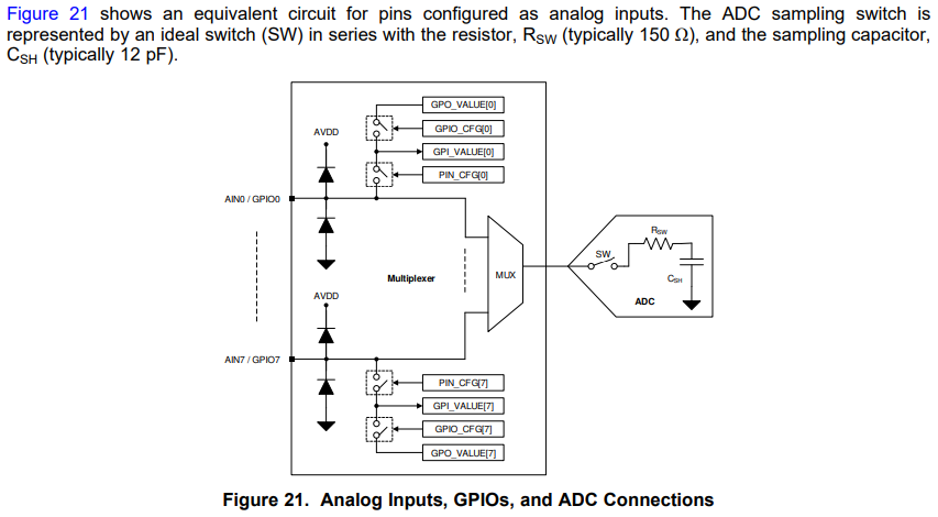

what is the analog input impedance of ADS7138? Thanks!
The analog equivalent circuit is shown in figure 21 of the datasheet. The input has a typical 150Ω resistance and 12pF capacitance.
Joel
The GPIOs have input impedance over 1MΩ, with capacitance ~1.25pF.
Joel
