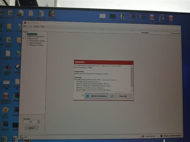

  • Hi Bryan,
    We are experiencing a critical issue while interfacing the ADS127L18EVM board with the provided software. The error message displayed is: "No PHI detected."
    To troubleshoot, we tested the setup using another PHI controller card that we had previously purchased for the ADS127L18EVM board. That card works correctly, confirming that the EVM board and software are functioning as expected.
    This indicates that the newly supplied PHI controller card is faulty or incompatible. The issue is causing significant delays in our project timeline, and we urgently request your support to resolve this matter as soon as possible.
    Please advise on the next steps or provide a replacement for the defective PHI controller card at the earliest.
