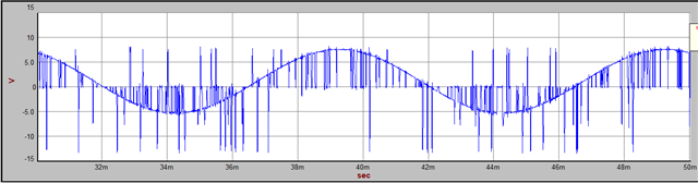

I have been encountering an issue with the ADS8598S.  I am getting some readings (seemingly) correct, but several readings seem to read incorrect voltages.
Right now I am communicating the ADC from an FPGA, which is also driving a DAC; for now just measuring the values from this ADC and reading them out through the DAC.  I believe the DAC is working correctly; it is an DAC8718.  I can output known codes or patterns to the DAC and it outputs follow.  To confirm it is the ADC and not the DAC, I have 8 LEDs connected to the fpga and I output the first 8 bits of the ADC data to the LEDs. When feeding +3V to the ADC I can see the MSB-Led flicker; indicating negative readings (since ADC outputs two's compliment).  This matches the spikes I see in the DAC signal.
I have also probed DB15, and can see it is often high for the MSB (sign) of the output of my channel.
The other strange thing I have noticed is that FRSDATA, which is supposed to pulse high on the output of the first channel, seems to pulse high several times during output of data.  This certainly seems to be a problem.

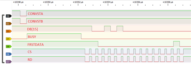

    Can you provide a schematic of your connections around the ADS8698S and perhaps a screen shot (o'scope or Logic Analyzer) showing CONVST, RD/CS and FRSTDATA?  For the reference, is that measured with a DMM or an o'scope?  If DMM, can you verify using an o'scope that the reference is a stable DC value and not oscillating?
  • Hi Tom,
    The reference was measured with a scope, and it is very stable DC value.
    Below is a screenshot from a logic analyzer, showing CONVST, CS, RD, BUSY, FRSTDATA, and DB[15].
    FRSTDATA seems incorrect; and as I showed

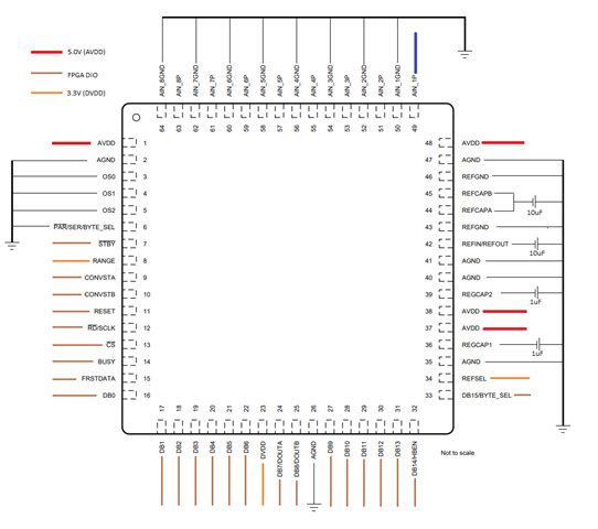

    For my schematic, I have configured it as suggested in the manual;
  • I'd still like to see your schematic and the actual raw data from the ADC.  If the reference is stable, it won't cause the spikes.  If you can get CONVSTx, CS/RD, BUSY and FRSTDATA captured with a 4 channel oscilloscope, that would also be helpful.
  • Hi Tom, please see the connections above.  I am measuring on AIN1 (Blue).

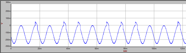

    But I do have another data point.  I switched to use SPI instead of Parallel data transfer.  In doing so, the spikes disappeared.  But, I have another strange issue in SPI mode; I get a weird jump in the signal when it crosses 0 - and it depends on the slope (positive to negative, or negative to positive):
    I guess my first question is to identify the issue with the parallel transfer, but I think this will be an issue as well.  Do you have any recommendations on what could cause this as well?
