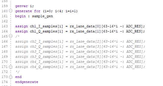

2. I also attempted to try a 2 lane receiver configuration. Am I correct in thinking it is as simple as configuring the transceiver wizard to two lanes as I have below, then setting NUMBER_OF_QUADS to 1 and NUMBER_OF_TX_LANES, NUMBER_OF_RX_LANES, lane mapping and lane polarity values accordingly in the relevant files?
I also needed to omit the below section of code within the refdesign_rx.sv file to resolve errors. I just wanted to confirm if this was correct and that it will not contribute to any wrong results, as I did not find anything specific on this in the TI204c-IP users guide.
