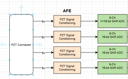

We are designing a data acquisition system that shall comply with the DO-160 military standard. In our system, we will be reading the data from the 32x channel PZT sensor as indicated in the block diagram.
In addition to this, we want to perform impedance/capacitance measurements of each PZT sensor channel by using, maybe, a DAC. Could you please provide a solution for this?

    Per your block diagram, the ADS8598S would be a good candidate to enable reading 32 PZT channels. The ADS8598S is an 8-Channel ADC and each channel also has an integrated front end so it could benefit from the configurable gain in the case the input signal is less than the ±5V or ±10V input range of the ADCs.
    Could you provide more information on what the signal would look after the "PZT Signal Conditioning" block? Or perhaps do you have a schematic we could review to make sure it is optimally configured for the ADS8598S?
    What is the expected type, range, speed of the signal?  Would the full 200kSPS be used/required?  or would a higher sampling rate be required?

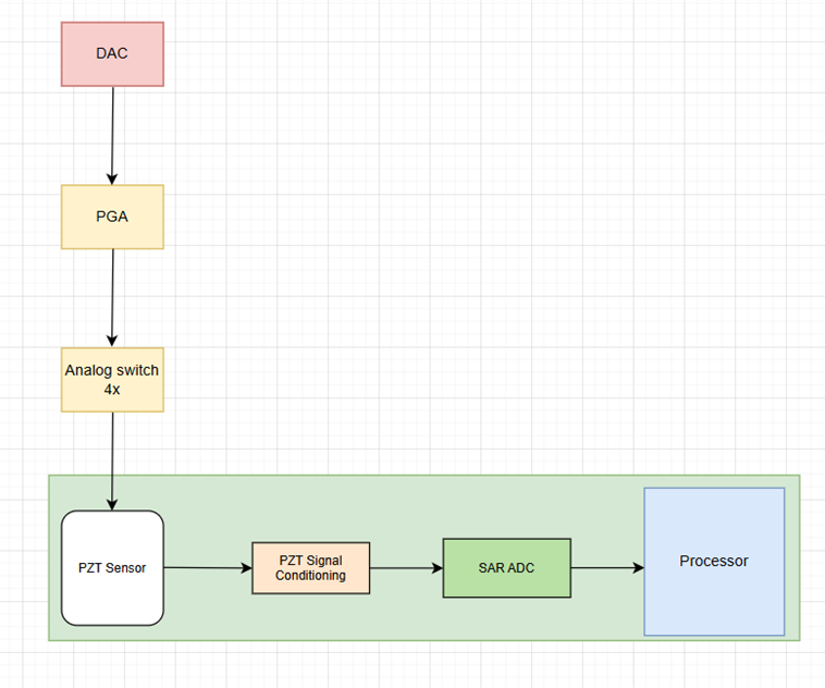

    Since we have 32x channels for the analog sensor, we are planning to implement the Impedance measurement process as per the block diagram mentioned below:
    The portion within the green block is already part of the system. And the rest of the part will be added in order to measure the Impedance.
    DAC: We will be using the Single-channel DAC61401 to generate the excitation signal.
    PGA: We will be using PGA849 to increase the amplitude of the signal as per our requirements.
    Analog switches 4x: We will be using 4x TMUX7612 analog switches and will be connected to the output of the PGA849.
    Since we have 32x channels, we will turn on maybe 8x channels at a time and read the impedance of it through the ADC section (in the green block).
    Our main concern is that when we turn on 8x channels simultaneously, there should not be any change in the amplitude of the signal received from the output of the PGA849.
    Please confirm if this approach is good to go.

  • Hi Sahil,
    This approach looks ok, though your device choice may be off. The max output of the DAC61401 is ±20V and the max output of the PGA849 is 36V unipolar or ±18V bipolar. You won't be able to gain the DAC output to ±50V with this PGA. Do you really need programmable gain along with the DAC? You'd still be able to vary the output voltage through the DAC with a fixed high voltage gain stage.
    I'll move this thread to the amplifier team so they can help you select an appropriate amplifier that meets the voltage requirement and the loading requirement to support the 8x channels.

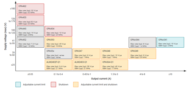

  • Hi Sahil,
    Resolution: The input voltage range for each channel of the sensor has an upper bound of ±50 V (100 VPP) and a lower bound of <= ± 1 V ( 2 VPP), so please consider the resolution accordingly.
    Could you provide the design information about PZT requirements? I assumed that you are talking about Piezoelectric sensor.
    If the PZT has to swing up to +/50Vpk, then the op amp's driving options are OPA455 or OPA464. OPA454 may be inadequate to drive the sensor.
    Here is power amplifier selections.
    https://www.ti.com/product-category/amplifiers/op-amps/power/overview.html

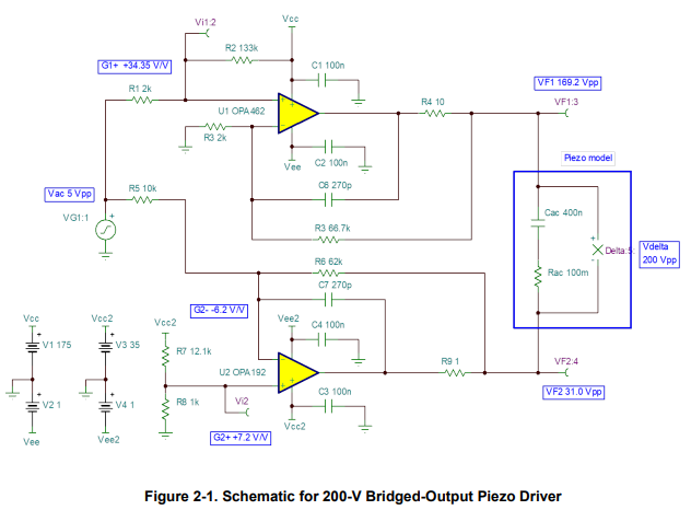

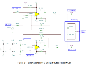

  • Hi Sahil,
    Here is a design of piezoelectric driver. It is using OPA462, but you may use OPA455 for your driver, since the output swing is operated up to +/-50Vpk in sinusoidal drive (up to 500Hz). Piezoelectric transducer is typically driving in a floating configuration (better efficiency to drive differentially), though you may drive it to GND as well.
    https://www.ti.com/lit/ab/sboa502/sboa502.pdf?ts=1757392624445&ref_url=https%253A%252F%252Fwww.google.com%252F
    If you are able to provide the transducer's L, C, R value, I may be able to put together a simulation for you.
    If you have other questions, please let us know.
    Raymond

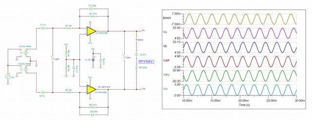

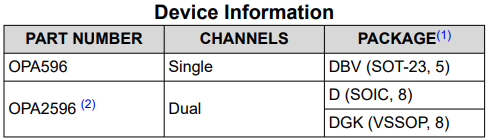

  • Hi Sahil,
    The only challenge we see here is to have the dual supply rail of ± 50 Vdc in our system, and this requires a bigger space as well.
    Here is another driving approach that can save you a power supply, butt the PZT has to be driven differentially or floating. With two OPA596 or single OPA2597 you may be able to drive the drive with a single 50Vdc + overhead. In the simulation, I picked 60Vdc. In practice, 55Vdc in a single supply rail may work for drive a PZT (100Vpp).
    OPA596 is a lower current power amplifier and it is capable to source or sink up to ±20mA range over temperature. The higher current version is OPA593. It looks like that the project is in concept stage.
    Here is the simulation.
    PZT 100Vpp Driver OPA596 09122025.TSC
    Regarding to your following stage, DAC + PGA may take more space.  For instance, you can use DAC to generate modulated high frequency SPWM (say 100kHz or higher) --> Once it is filtered, you can create perfect sinusoidal waveform at 500Hz. I do not know how many gain stages you have. If the application requires multiple gain stages, then PGA may make sense, otherwise, it is not necessary.
    Please let me know if you want to transfer the query back to DAC team. The query is getting long, I would recommend to start a new one.
    Raymond

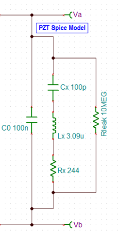

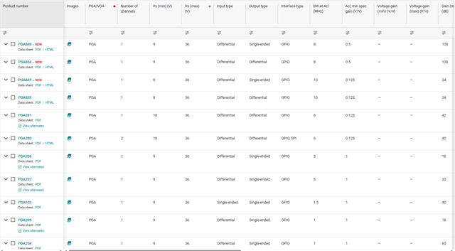

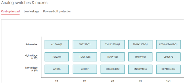

  • Hi Sahil,
    Katlynne is correct. There is no PGA op amp that is able to provide the voltage swing and current requirements. You have to use DAC-->PGA -->OPA596 to drive PZT requirements.
    I do not know how many programmable gains you need per your requirements. PZT is typically driven differentially, so it will be the best to send differential input to the OPA596 PZT driver. PGA855/PGA281/PGA280 and other PGA may be a good option. If you only have a handful of gain settings, I would recommend to use Mux or analog switch as the gain selections.
    If you are able to provide me with a PZT part number or the Spice model, I can simulate the schematic for you. We have OPA2596 op amp (should be RTMed in a few weeks), a dual op amps in SOIC-8 package, which is the great match for driving the application.
    A realistic PZT Spice model typically looks like the following. So I would need to know these typical L, R, and C parameters in order to simulate it properly.
    https://www.ti.com/product-category/switches-multiplexers/analog/overview.html
    PGA selection is shown below.
    https://www.ti.com/product-category/amplifiers/pga-vga/products.html#3229=PGA&sort=358max;desc&
    BTW, most of the above PGA op amps are supported by PSC team in Dallas. If you prefer to go with PGA design approach, please contact the team.
    Best.
    Raymond

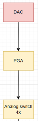

  • Hi Katlynne,
    We have a high current (~1A), high slew rate arbitrary waveform generator DAC, which is capable of generating a ±50 V signal. We are planning to connect the DAC signal to all 32x channels of the PZT sensor.
    Will the above-mentioned connection setup have any loading effect? Will it be able to drive all 32x channels simultaneously?
    If not, let us know what issues could arise in this setup.
  • Hi Sahil,
    What DAC is this? Considering we don't have any 50V waveform generator DAC I expect it is from another company, and you'll have to ask them about the loading capability of that DAC. They likely have load vs regulation specs that will tell you how the output is affected when loaded.
    Or if it is from TI please share the part number and we can look into the specifics.
