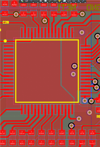

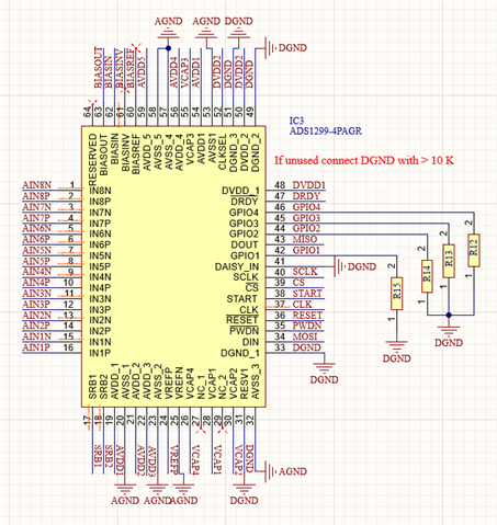

Hello, I have designed an EEG amplifier by using ADS1299-4.
The system has an AD1299 and a Bluetooth chip NRF52840.

    the problem I face is that I cannot get required voltages from Vcap 1 - 2 - 3 - 4 pins and Vref
  • Required  Read
    Vcap1  Avss+1.2 0.04V
    Vcap2 (Avdd+Avss)/2 0.3V
    Vcap3 Avdd+1.9 4.19V
    Vcap4 (Vrefp+Vrefn)/2 0.5 V
    Vrefp 2.5 0 V
    If someone can help me to understand the source of the problem, that would be great for me.

    Have you checked all AVDD, AVSS, and DVDD pins on the ADS1299 as well? Can you measure the AVDD supply current? As long as /RESET and /PWDN pins are high, VCAP1 should ramp to ~1.2V. VREFP will only show the proper voltage once the reference buffer is enabled.

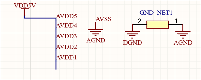

    I see that you have named the AVDD connections separately - are these all connected together elsewhere in your schematic? Similarly, are AGND and DGND shorted together?

    AVDD pins are separated to read the schematic easily, so they are from the same source. Also, ANGD and DGND are tied with a 0-ohm resistor at a sigle point to reduce noise.
    AVDD measured 5 V and DVDD measured 3.3 V in PCB.

    When I send a bit message via Bluetooth, I see a very brief logic high on the reset and PWDN pins (power up sequence recommended in ads1299 datasheet), then the Bluetooth shuts down.
    When I power the reset and PWDN pins high with an external source, I can read the voltages I need on the VCAPx pins.
    I know that when I power up the ADS1299 before sending the bit message, I should see 6.9 V on the VCAP3 pin ( but I see 4.2 V).
    I think this is the root of the problem.

    It seems like the ADS1299 is functioning properly as long as /RESET and /PWDN pins are held high (i.e. disabled).
    I would check the controller outputs connected to the ADS1299 digital I/O pins during power up and after your initialization command sequence.
    Ryan
  • Hello Ryan,
    Yes, exactly. It seems that problem is caused by the MCU, but as I know, the Vcap3 pin should be 6.9V with only a power supply.
    I removed the MCU to see if VCAP3 is 6.9V, but it is again 4.2V.
    After seeing 6.9V on VCAP3, the initialization command sequence should follow, then VCAP1 gives 1.2V, and ADS starts to function.
    I need to find why VCAP3 doesn't show 6.9V.

    You may need to complete the power-on reset initialization sequence in order for VCAP3 to show the correct voltage. I believe this is an internally generated boost supply rail that is used by the PGAs. The boost circuit may only become active once the device is fully powered and initialized.
    VCAP1 should ramp to 1.2V at the same time as the analog supply voltage.
    Ryan
