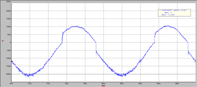

I am controlling this ADC with a FPGA, and getting a strange glitch when I cross zero. Below is a sine wave input to the ADC, and re-output by a DAC (DAC8718). The DAC appears to work fine, I can output any other codes I generate in the FPGA with no issues.
I am using SPI to communicate, had issues with parallel mode that I am still working through.  But this does not seem - at least on the surface - to be related to poor communication/signal strength.
The output code of the ADC seems to jump up when I cross zero from below; and seems to jump down when I cross zero from above.  Below is the output of the DAC, when a sine wave is read through the ADS8598:

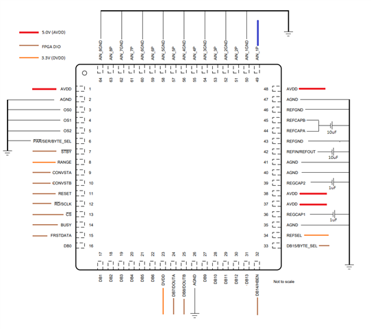

If I don't cross zero, I dont have an issue.  Sampling at 100kHz, schematic below:

  • Interestingly enough, I dont seem to have the issue on ch2 of the ADC.  Could Ch1 just be damaged?

    Is there a difference in the signal path between channel 1 and channel 2? either in the circuit/schematic or in the input signal.
    Would you be able to share a schematic showing what the input signal chain looks for the ADC channels?
