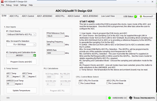

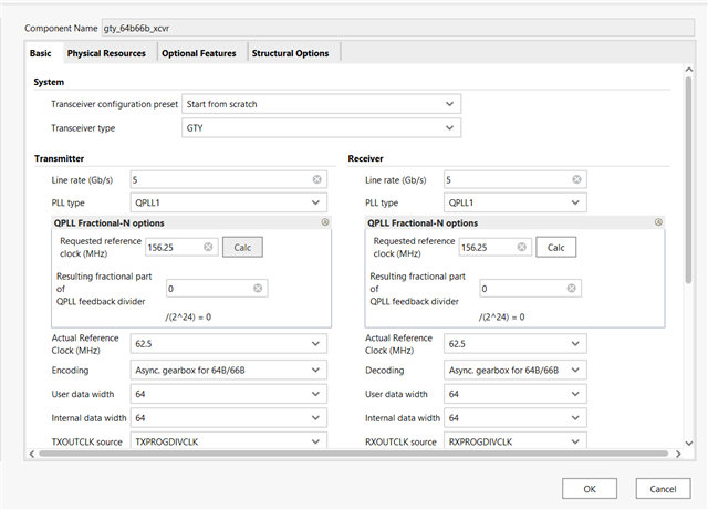

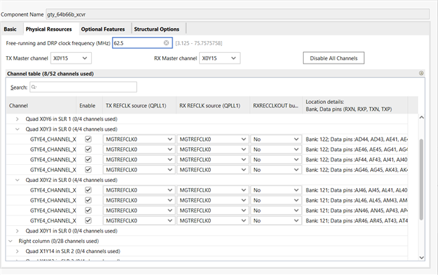

I cannot seem to get the QPLL to lock in a design I am working on.  I am using a TSW12QJ1600EVM connected to a Xilinx VCU118 dev bd.  I have mapped the correct pinouts, have verified that I am getting a ref clk, and think that I have it set up correctly, but it will not lock.  I have tried, QPLL0, QPLL1 and CPLL but nothing will lock.  Here are the GT xcvr setting and the ADC GUI I am using.  Is there a reset sequence I am missing?
