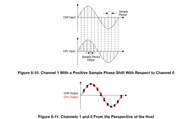

I have gone through the datasheet for channel phase compensation.
If there is phase shift of 2.25 sample between 2 channel, we can create a shift of 2 sample channel1 wrt channel0, and 0.25 we can adjust using phase calibration function. In this case calibration function is same as configuring the PHASEn[9:0] bits in the CHn_CFG register?
In order to compensate any channel phase error, we need to find the the Sample Period offset between two channel. How we can find this sample period offset?
And if Sample period offset is 0.25 sample, how to get bit pattern of  PHASEn[9:0] BITS?

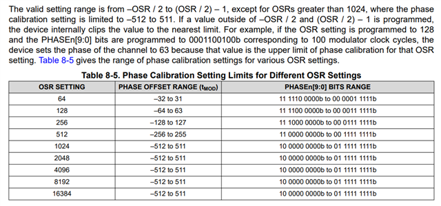

    The datasheet description lists the phase calibration settings and the range for each OSR - I have copied this below
    So if your OSR = 2048 then the phase offset range is -OSR/2 to +OSR/2 (or effectively +/-1/2 a sample period). This corresponds to a decimal value range from -512d to +511d. Therefore, you would program an approximate value of +/-256d to phase shift by 1/4 sampling period.
    You should be able to calculate the time difference between two signals by actually measuring them. You can use something like zero cross detection to determine the phase difference, then use the phase adjustment register to help correct for this
    -Bryan
  • Hi Bryan,
    I understood that based on OSR, i can keep Phase offset value within the range it is mentioned.
    But what i need is how i can find the phase difference error based on the time difference between two signals?
    Also, once you get the time difference or phase difference between two signal, how i will know what phase offset value to be selected for respective OSR? For example I kept OSR is 256, So i can set -128 to +127, but between this range what value i need to keep? Can you give me example?

  • Hi shraddha naik,
    I included an example in my last post about how to convert the phase offset range for a specific OSR to 1/4 sampling period
    Yes I understand this, I also mentioned zero cross detection in my last post, and how you would use the difference between the zero crossings of two signals t determine their phase difference. Did you not read my post?
