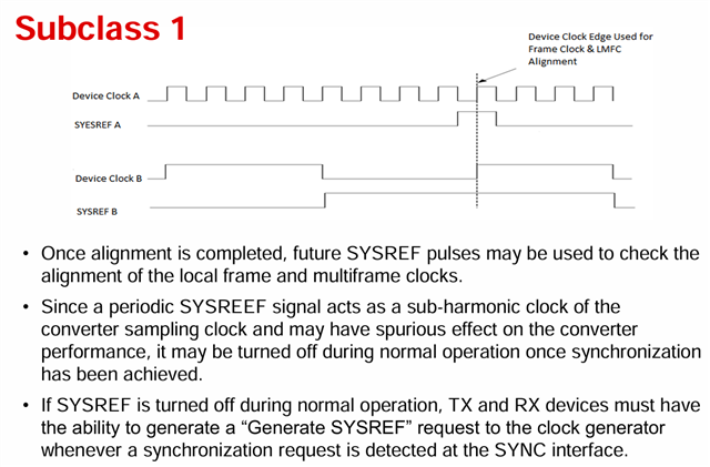

I have a question about the timing of SYSREF and device clock.
According to the section 7.3.3.1 of the ADC datasheet, it seems to mean that the rising edge of SYSREF should be aligned with the rising edge of device clock. Is this understanding correct?
On the other hand, looking at TI's other documentation, it appears that SYSREF is being triggered when the device clock falls.
Which is correct?
Thank you.
Sayaka Kose
  • Hi Sayaka,
    The sysref is on the rising edge for this device. The second figure you show indicates that the SYSREFB changes from low to high on the falling edge as this is the best time to ensure to stray sysref occurs from setup/hold timing. The SYSREFB is latched on the clock rising edge as shown.
    To synchronize the ADC32RF55, you must supply a common SYSREF as well as a source synchronous clock input to both devices. The device requires SYSREF during bringup sequence in a few places to synchronize internal blocks. If these blocks are not synchronized across the ADCs at the same time, then you may not achieve true synchronization.
    Thanks, Chase

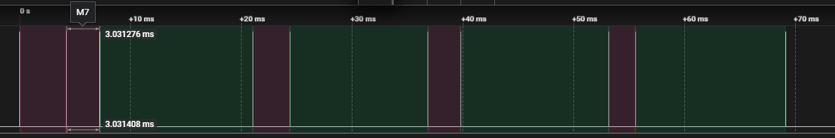

  • Hi Sayaka,
    The tool takes 223ms on average between the last LMK register write and the first ADC register write. The GUI SCLK frequency is approximately 3.75MHz.
    However, the nature of calling a DLL for each register operation as our tool does the minimum delay between any sequential spi transaction seems around 3ms. Due to the added step of read and modify before the next register write can occur, the delay between any two register write operations is around 16ms (red + green regions) if the register has to be manipulated.
     The transaction below shows the following sequence:
    ADC32RF55.write(0x005,0x00)
    ADC32RF55.write(0x005,0x40)
    ADC32RF55.read(0x06D) = 0x00
    ADC32RF55.write(0x06D,0x40)
    ADC32RF55.read(0x06D) = 0x40
    ADC32RF55.write(0x06D,0xC0)
    ADC32RF55.read(0x06E) = 0x00
    ADC32RF55.write(0x06E,0x01)
    ADC32RF55.read(0x06E) = 0x01
    ADC32RF55.write(0x06E,0x03)

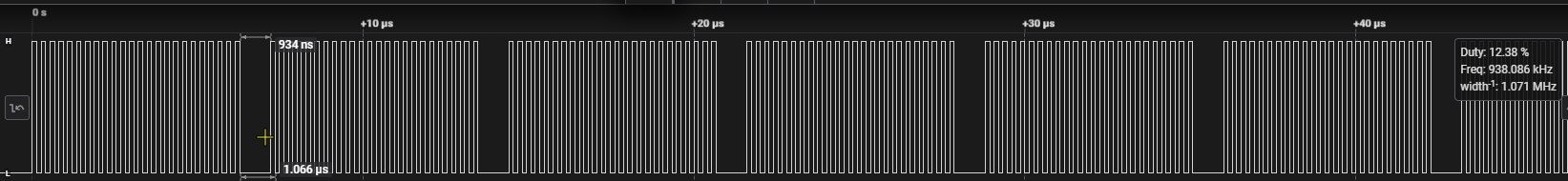

    So if just using the generated register sequence, then the GUI transactions for any two sequential writes will occur on average every 3ms.
    I have just added a feature such that the imported sequence is much faster now than before. Instead of being the same 3ms delay between two register writes, I have made it so now I perform the register operations in chunks without making multiple calls to the DLL. This made it such that sequential writes to the ADC occur with a delay of 1us now, yes 1us. This still works to program the ADC and performance looks as expected. I think any issues you are facing is due to clock related or again due to delay problems.
