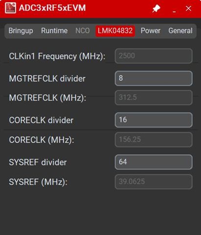

① I want to run FPGA with original implementation, but the value of divider in LMK setting is automatically 8/16/64 when BringUP. Do I have to change the receiver (FPGA) with this condition?
Why is it forced to this value during BringUP? Is the reason a constraint on the ADC32RF55 side? Or is it an EVM specific constraint?

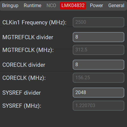

② I know that if I change the value of LMK page after BringUP, the value of SYSREF etc. will be changed. For example, if I want to proceed with the value of each divider at 8/8/2048, is there no problem with the following procedure? Is there any other necessary procedure?
[Procedure]
・Use ADC tool to DeviceBringUP

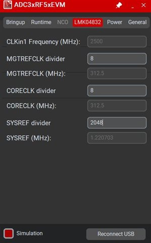

・Set LMK to 8/8/2048.
・Write FPGA to TSW・・・EVM evaluation board.

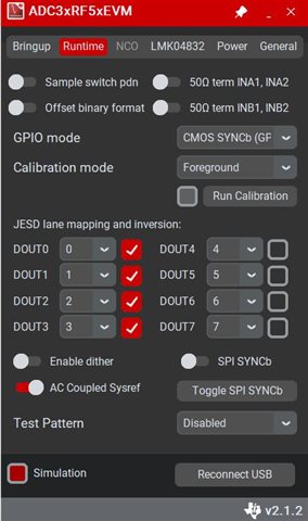

・Press Toggle SPI SYNCb.

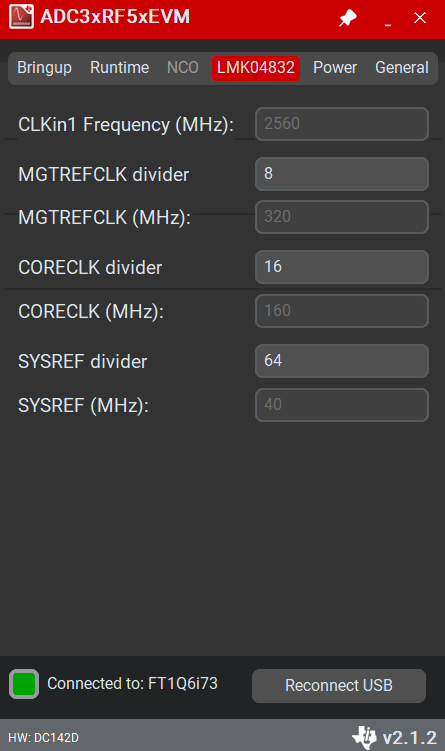

③ When running ADC32RF55 using the original board, should the divider value of LMK setting be designed to be 8/16/64 during BringUP? Should we not design an arbitrary divider value from the beginning?

  • The GUI is setup to work with TSW14J58EVM out of the box for easy eval. You can change LMK divider afterwards to work for your setup. Alternatively program LMK first and uncheck the Set FPGA Clocks option before Device Bringup. It will not program LMK with values meant for TSW14J58EVM and HSDC Pro evaluation.

    Situation (1) The sample clock is 1.25Gsps, the divider value is 8/8/1024, and K=16.
    Data acquisition succeeds.
    Situation (2) The sample clock is 2.5Gsps, the divider value is 8/8/2048, and K=16.
    Data acquisition fails.
    Situation (3) The sample clock is 2.5GSPS, the setting that matches Set FPGA Clocks (Divider value is 8/16/64, K=16).

    When I set the LMK's clock 2.5Gsps, the divider value is 8/8/2048, I also set the FPGA's setting to the same.
    The settings on the FPGA side and the LMK side are the same each time, but as you can see above, the data acquisition succeeds or fails depending on the settings.
