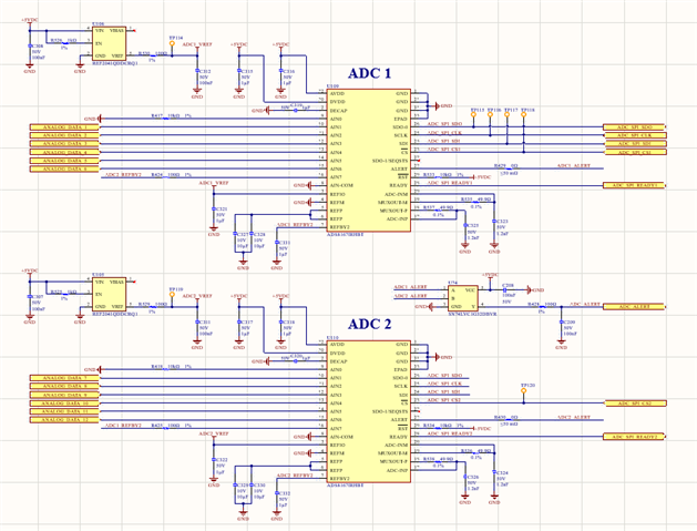

Dear TI Support Team,
We are using ADS8167IRHBT devices in one of our ongoing projects. Our system consists of a Power Board and several other functional boards.
Observation:
On the Power Board, the ADS8167 devices operate without any issue. For example, when monitoring the REFBY2 pin through an analog input channel, the measured value remains stable at ~2.048 V, with only a few mV variation. Also, inputs expected to be at 0 V are read by the MCU as ~7–8 mV.
However, on another board which receives its power and ground connections from the Power Board, we observe significant instability on the ADS8167 devices, even though the same schematic and layout have been applied. When REFBY2 is read over SPI, it fluctuates continuously. Based on the software monitoring graph, the value drops rapidly from ~2.048 V down to ~0.4 V and then returns back. In addition, inputs expected to be at 0 V show readings in the range of 300–800 mV, and sometimes even higher.
Additional Information:
All ADCs are supplied with an external 4.096 V reference (REF2041).
Decoupling capacitors are placed very close to the pins in accordance with the datasheet recommendations (REFP–REFM: 22 µF, REFBY2 and REFIO: 1 µF, VDD: 1 µF).
The problematic PCB is 14-layer, with 4 dedicated GND planes, and power/ground is distributed strongly through multiple pins.
The same topology works stably on the Power Board, but REFBY2 and input readings are unstable on the other board.
We have investigated this issue but have not yet reached a clear conclusion. We would greatly appreciate your technical feedback and guidance. Our schematic is also attached below.

  • Hi Erhan,
    Thanks again for the detailed post. The behavior you are seeing is definitely strange. In the problem device/board, could you try probing the AVDD, DVDD, and all reference pins and let me know if they are holding stable at the expected values? Additionally, are the SPI signals in both devices connected similarly, that is, nothing is loading the digital signals, right?

  • Hi Erhan,
    Thanks for the information. I checked with the team and we are wondering if the issue you are seeing is because the REF/2 pin is not driving the input pin correctly, as this is not really what it is designed to do. The 100 ohm resistor on the AIN7 signal path is probably also contributing to this. Could you check if it is really a 100ohm resistor (and not a larger one)? The fluctuations you are seeing on the REF/2 pin may be caused by the kickback from the ADC sampling capacitor.
    1. Could you try powering up the device, leaving the SPI idle (so the ADC is not converting), and checking if the REF/2 pin is fluctuating or not?
    2. You can try replacing the 100 ohm resistor on the AIN7 input with a 0 ohm resistor/short and resume normal SPI activity. Is the instability improved?

  • Hello Samiha,
    We removed the 100 Ω resistor that connects the REF/2 pin to the AIN input. When monitoring the REF/2 pin with the oscilloscope, we did not observe any fluctuations. The data read from the AIN input still remains highly unstable. Replacing the 100 Ω resistor with a 0 Ω resistor also made no difference.
