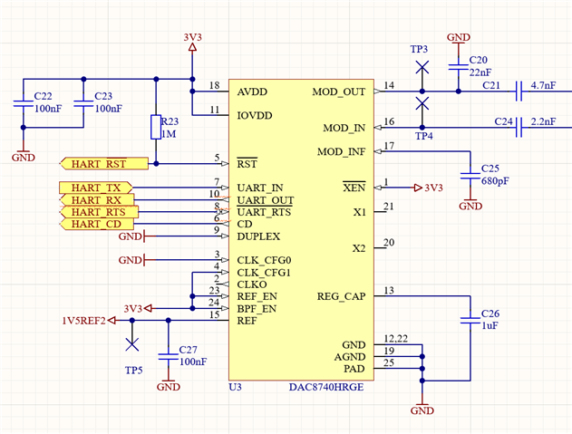

I'm building a HART field device (DUT) using the DAC8740H with UART. The Hardware is similar to the reference design Figure 34 in the datasheet (page 33).

    I looked at the plot, and it does look like the stop bit is misinterpreted. It looks like this is the 0xd7 byte transmission of the last four 0xa3d70ac2 that you had mentioned. Admittedly, I don't know what this yet.
    Can you provide a schematic of your setup? I think just the DAC8740H part of it would be fine. Just to be clear, this is an error in the HART reception, so that this is the HART signal coming into MOD_IN and coming out of UART_OUT? How long is the total transmission that you're receiving? Are you only getting errors in the last four bytes? Is there any extra space between the byte communications? Are you using an external oscillator or using the DAC8740H internal clock?

    here is my schematic of the DAC8740H:
    I'm using the internal clock and the internal filters. However, I use the 1V5REF2 also for the 4-20mA interface as Vref (Figure 35 in datasheet). The measured voltage is 1.48V. After removing it from the 4-20mA interface, the framing errors still exists. In a new design it will be removed as it is bad practice.
    The measurements are taken at the UART_OUT (HART_RX) and MOD_IN (TP4). This is an error in the hart reception. The total transmission contains 19 bytes: 0xff ff ff ff ff 82 80 00 00 00 00 83 05 03 3b a3 d7 0a c2
    Errors can appear everywhere but are more common in the last 4 bytes. There is no extra space. Here is a snapshot of a full transmission (UART green, Carrier Detect red) with an error:

  • Nico,
    Sorry, I didn't get back to you earlier.
    It does look like the HART signal is a little fast. If the transmitted frame length is 8.854ms, that is about 3.4% faster than expected. I do expect that the DAC8740H would be able to keep up with some mismatch in the frame speed. However, that's a bit much.
    Just to be sure, can you check the transmission of the DAC8740H to see the timing of the signal? You may just be able to set /RTS and turn on the DAC8740H modulator. When that happens, the device should send out a 1200Hz sinusoid. With that, you can check to see that the device is at the correct frequency as well (is this 1200Hz output too fast or slow also?).
    I would have expected that any given frame could potentially be misread, so I wouldn't have expected the problems all at the end of the frame. However, I think that the faster frames could really be the problem.
    Joseph Wu
