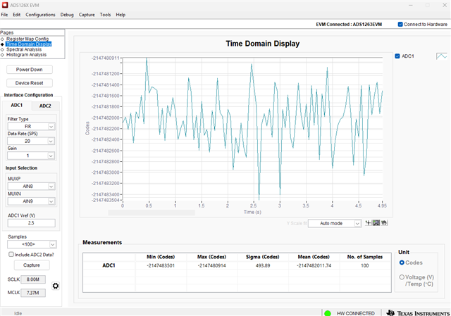

  • Hi Brian Marriage,
    I tried some tests on my EVM using the following settings / conditions:
    • AIN9 = REFOUT, AIN8 = ground
    • PGA = bypassed
    • Internal VREF
    • SINC4 filter, 100 SPS, measured 100 samples
    I then measured both AIN9-AIN8 (+2.5V) and AIN8-AIN9 (-2.5V). As you can see from the plots below, measuring 2.5V yields a positive full-scale signal just like you expect. However, measuring -2.5V yields randomly-varying codes that are near, but not quite at, negative full-scale. This indicates to me that this ADC has a positive offset and a negative gain error. I then measured an offset error of 57uV and a gain error of ~50ppm. As mentioned in my previous post, I assume you could have a similar situation.
    Can you try performing the same measurements on your board to see if the result is the same? You can then play around with the OFCAL and FSCAL registers to see if you can determine the actual offset and gain errors in the system. The offset can be measured directly by shorting the inputs to mid-supply. You can do this easily by setting MUXP=MUXN=REFOUT (you mentioned a "zero input", but it wasn't clear to me how you made this measurement and what the result was - there should have been at least some offset that needs to be accounted for). You can dial in the gain error using some math and a bit of trial and error once the offset is removed.
    I assume you are disabling the PGA for these measurements, because you must be applying REFOUT to AIN6 and then tying AIN7 to ground (or vice versa) - is that correct? The analog inputs cannot be connected to ground when the PGA is enabled
    MUXP = AIN9, MUXN = AIN8 (VIN = 2.5V)
    MUXP = AIN8, MUXN = AIN9 (VIN = -2.5V)
