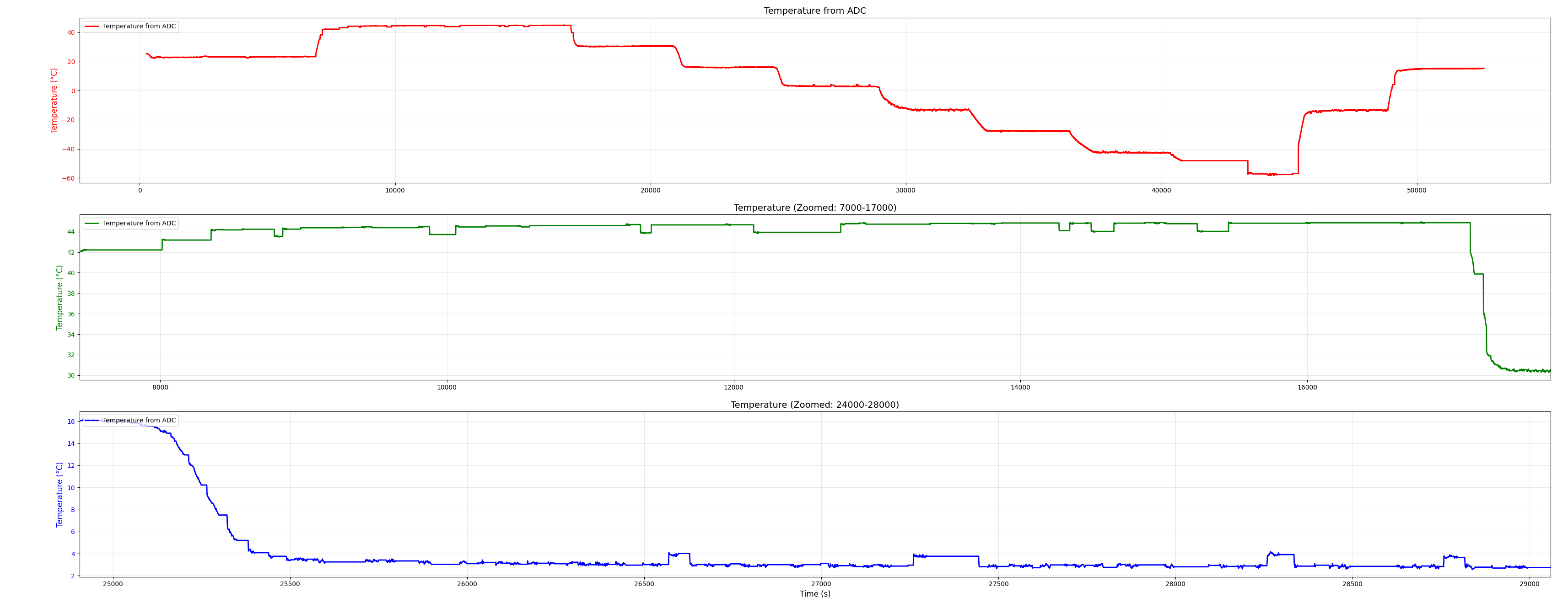

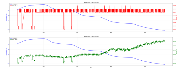

We have observed two different voltage offset levels during bootup of ADS7142, that persists while the device is powered on, despite offset calibrations/software resets. These levels are 16 LSB apart, and the probability of  the specific offset level occurring seems to depend on temperature. This offset seems to be very consistent and reproducible across different devices and even platforms, and translates to approximately 500uV after conversion. The offset is shared between the channels of a converter, but not between different converter units. Otherwise the offset calibration seems to be accurate up to 1 bit level.

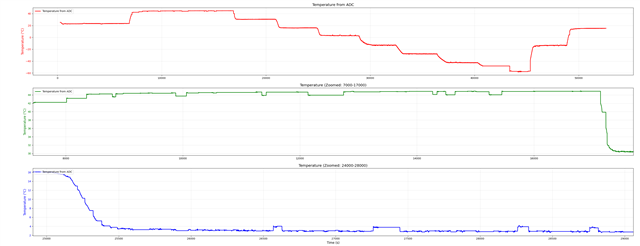

Below are some plots of the phenomenon. Note the difference in behavior when rebooting the device during test in Fig. 2. and when the device is powered for the full duration of the test in Fig. 3.
Fig. 1. Plot of a temperature sweep from 45degC to -10degC. The device is powered on and off periodically. AD1 is connected to GND and AD2 measures a node between two resistors. The resistors appear to have some temperature dependency.
Fig. 2. Temperature measurements utilizing AD7142 AD converter. The device is powered on and off periodically. Voltage offset levels can be seen switching polarity based on temperature.
Fig. 3. Temperature measurements while the device is constantly powered on. The offset levels appear stable despite offset calibrations and software resets.

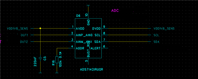

Here is our schematic around the AD converter. Note it is not possible for us to monitor the BUSY/RDY line.
Fig. 4. Schematic around the converter.

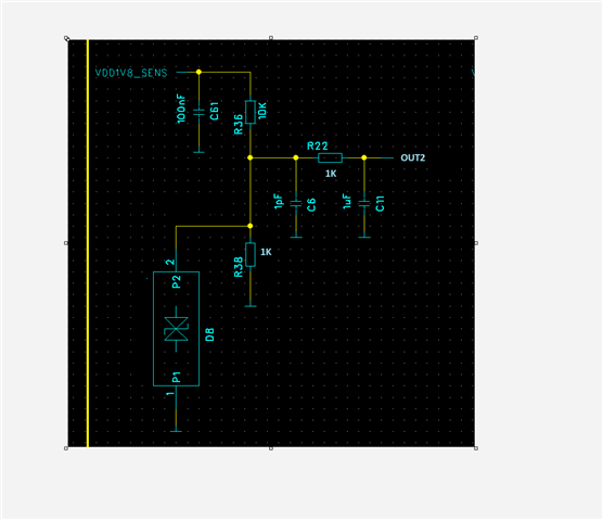

    The input schematic is shown in Fig. 5.

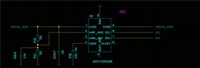

    In Fig. 1 for AD1, OUT1 (same schematic as in Fig. 5) is connected to GND to serve as a known reference and so is node R38-R36. We have also tried changing C11 value to 470pF and 200nF. Changing the input side schematic such as in Fig. 6, as well as changing C5 value (tried values: 220nF, 1uF, 10uF) in Fig. 4 appears to modify the probability function in Eqs 2. Nevertheless, we always observe some nonzero probability for both A and B for some temperature range between (45degC, -60degC).
    Fig. 5. Schematic of AD converter input side. OUT2 is connected to AD2 of the converter.
    Fig. 6. Different use case of ADS7142. The phenomenon remains observable despite changes in ADC input schematic.
