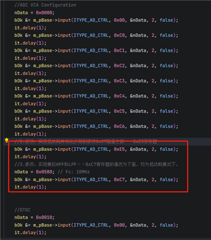

Hi Sir/Madam,
Could you please give me some suggestions or helps regarding configuration of the AFE 5832's LNA-HPF and LPF. The beamformed signal and then b-mode imaging seems having no changes after I configured the LNA-HPF and LPF registers of the  AFE5832 device  with the Fc values of the LNA LPF from 5MHz to 10MHz. It is supposed to have some influences on signal frequencies. My configurations and imaging are  as follows:
Are there anything wrong or could you please give me some kind of suggestions.
Thank you very much!
