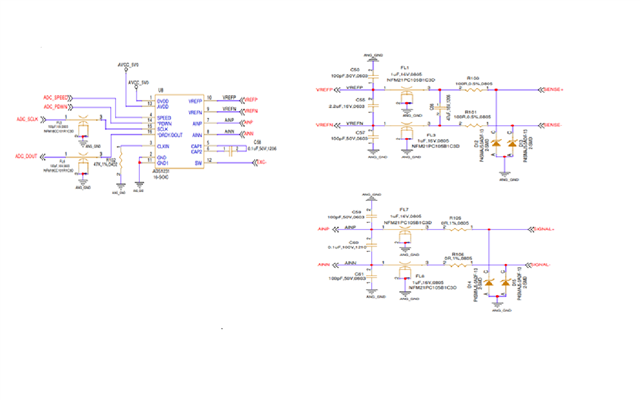

We have used the device ADS1231 in our new design "PLC - Load Cell Input module".  This module provides one input channel to interface with a 4-wire or 6-wire strain gauge load cell sensor, supporting sensitivity levels from 0 to 3 mV/V.
Currently, our design is in the final testing phase of R&D prototyping. During this phase, we have observed an issue: at room temperature (25C) the module output takes 30 to 60 minutes to stabilize, and the measured output count drifts from its initial value over this period.
For example, we used a load cell calibrator to apply a 3 mV/V input to the module. For 3mV input applied, the expected digital output count for this input is 32,000. However, we observed that the count initially starts at approximately 32,001 and slowly increases, stabilizing at around 32,011 after 30 minutes. Please refer to the table below for detailed observations.

For your reference, we have attached the schematic diagrams for the ADS1231 circuit and the input channel.

  • Hello Rohidas,
    This long settling time is likely due to dielectric absorption (DA) in the filter capacitors. Any ceramic capacitor greater than about 100nF will be a multi-layer construction and tends to have very high DA.
    https://en.wikipedia.org/wiki/Dielectric_absorption
    The filter capacitors in the input signal path as well as the CAP1 and CAP2 pins of the ADS1231 are all sensitive to DA.  All of these capacitors should be NP0/C0G type ceramic to minimize settling time due to DA.  It is likely the 1uF feedthrough capacitors are X7R type.
    1.  Verify the CAP1/2 capacitor and C60 differential AINx capacitor is NP0/C0G type.
    2.  The input signal is on the order of 100's to 1000's of ohms depending on the bridge resistance value and is more sensitive to DA.  In this path, remove the common mode 1uF feedthrough capacitors and check if this improves settling time.

  • Hello Rohidas,
    I should have looked more closely at the total code change.  I assume the codes you provided are direct codes from the ADS1231.  With a nominal code of approximately 32008, this translates to an input voltage of 74.524uV.  The average code change from time=0 to time=60min is approximately 6 codes, which translates to a voltage change of 14nV.
    The typical offset drift over temperature is 20nV/C, and can be higher for an individual ADC.  You could easily see a change of 0.5C or more over an hour in a typical lab environment or office setting.
    Also, any stress (pressure) applied to the board could cause small offset voltages in the capacitors or the ADC package, requiring many minutes or 10's of minutes to return to the initial state.

  • Hello Rohidas,
    Thank you for the additional information; this is helpful to better understand your test setup.
    The drift that you observe is much higher than expected.  Looking at the schematics again that you initially provided, it appears that you are using TVS diodes on the inputs for protection.  Normally, these devices can be used, but if I read your schematic correctly, you are using the 5V version.
    P4SMAJ5.0ADF-13 : Please confirm this is the correct part number.
    https://www.diodes.com/assets/Datasheets/P4SMAJ50ADF_P4SMAJ85ADF.pdf
    Taking a look at the datasheet, the maximum reverse leakage current of this TVS diode is 400uA.  In your case, you are operating at 2.5V, and the typical leakage current for these diodes will be much lower, but leakage current is probably in the 10's of uA.  Using a 350Ohm bridge, every 5nA difference in leakage current will result in 1uV of error.
    Please remove the TVS diodes from the Signal+/- inputs to see if this shows an improvement.  Even if this is not the source of error, I suggest you change these values to the P4SMAJ10ADF version, which has a maximum leakage of 1uA.
    Although not nearly as sensitive, the TVS diodes on the Sense+/- lines could also cause some change in readings, so I would recommend changing these to the P4SMAJ10ADF version as well.

  • Dear Keith Nicholas San,
    Thank you for your valuable suggestions.
    We have removed the P4SMAJ5.0ADF-13 diodes from both the Signal+/- and Sense+/- lines. With this change, we observed some improvement in the readings at 25°C room temperature, and a significant improvement in readings during the 60°C high-temperature test.

  • Hello Rohidas,
    I am glad this improved measurement stablity.
    Change 1 and Change 2 Query:
    The 10V diode will clamp at a higher voltage depending on the magnitude of the ESD event; worst case you can use the Max clamping voltage of 17V.
    For ESD, the time width of the pulse will be on the order of 10's of nanoseconds, in which case we can use the 100mA peak rating of the ADS1231 input current.  For a safety margin, we should limit worst case momentary current to no more than 50mA.
    Rin = (Vpeak - Vmax)/Ipeak = (17V - 5.3V)/0.05A = 234Ohm.  Round up to 249Ohm input protection resistor for R105/R106.
    In reality, the filter capacitors will limit the maximum voltage to much less, acting as not only a noise filter but also a filter for ESD.  You will likely be fine if you keep the 100Ohm resistors, but further analysis may be required.  I suggest increasing to 249Ohm for more safety margin.
    Change 3 Query:
    The larger value capacitor will provide additional noise filtering and should not cause any stability concerns as long as the leakage current over temperature is small.  I would fully test the circuit over temperature to validate, but do not expect any problems with these changes.
     We have implemented the following modifications:
    1. Replaced the diodes on the Signal+/- and Sense+/- lines (D12, D13, D14, D15) from “P4SMAJ5.0ADF-13” to “P4SMAJ10ADF-13”.
    2. Replaced the input resistors on Signal+ and Signal– lines (R105, R106) from “RES, SMD, MFR, 0Ω, 1%, 0805” to “RES, SMD, MFR, 100Ω, 0.5%, 1/8W, 25PPM, 0805”.
    3. Replaced capacitor C58 (connected to CAP1 and CAP2 pins of the ADS1231) from an X7R type “0.1µF, 50V, 10%, X7R, 1206” to an NPO type “0.1µF, 50V, 2%, NPO, 1206”
      Following these modifications, we conducted the following tests:
    1. Analog Accuracy Test: We tested the analog input accuracy at ambient temperatures of 25°C and 60°C. In both cases, the accuracy results were within the specified limits..
    2. ESD Testing: We performed ESD tests (contact discharge ±4kV and air discharge ±8kV) on the Signal+/- and Sense+/- lines in our simulation lab. The modules passed both contact and air discharge tests successfully.
    Based on these results, the modified modules appear to meet both analog accuracy and ESD protection requirements.
    Please let us know if you have any comments on the above modifications and test results. Also, kindly advise if any additional validation tests are recommended to further confirm the impact of these design changes.

  • Hello Rohidas,
    This is excellent news.  I do not have any additional recommendations at this time.  I can do a quick review of your board layout if you send an image that shows the ADC and all surrounding components.  The fact that you are able to pass ESD suggests that your board layout is already good.
