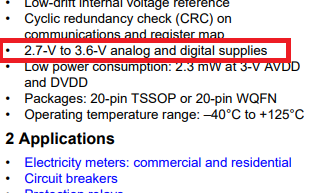

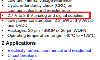

I'm using ADS131M02IRUKR and I need to change the SPI interface from 3.3V to 1.8V.
Is there a good way to do this?

Hi Rice,Lee,
Please read the datasheet in detail, of course we cannot fit all of the information on the first page
See below from the recommended operating conditions about the conditions to operate the ADS131M02 at 1.8V IO voltage. This is as Joachim described.
