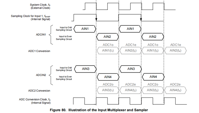

I would like to configure the AFE58JD32 as the ramp output mode (we are using the JESD204B interface).
I would like to confirm if it is sufficient to set bits 9 to 7 of register 2 to 111 in order to configure the AFE output to the ramp mode?
thank you:)
BR
  • 16 ADCs are used to convert the 32 inputs. Each ADC converts one odd numbered input (processed in the VCAo die) and one even numbered input (processed in the VCAe die) in a time multiplexed manner.
    Another question is: I would like to confirm how to split the data of odd and even channels in the JESD output mode.
