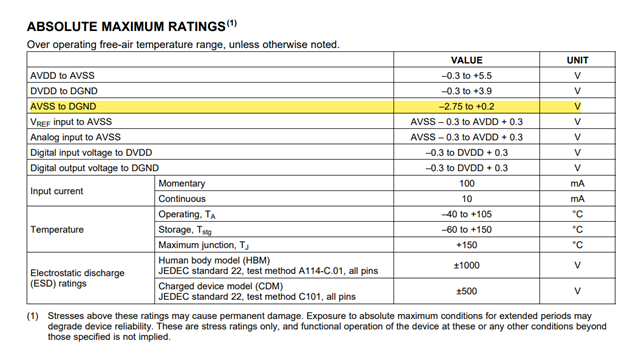

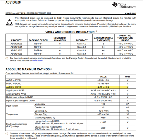

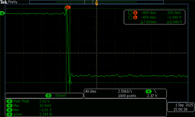

We are using +2.5V and -2.5V dual power supply for ADS131E08 and for VEE supply we are using IBB configuration.
In our testing we observed overshoot and undershoot on -2.5V supply coming from IBB configuration for the short duration as per below waveform ( +0.2V undershoot and overshoot of -2.84V for VEE supply ) .
Is there any problem for ADC ADS131E08 due to this short duration overshoot and undershoot ? as this limits are on threshold of absolute maximum limit mentioned in datasheet
