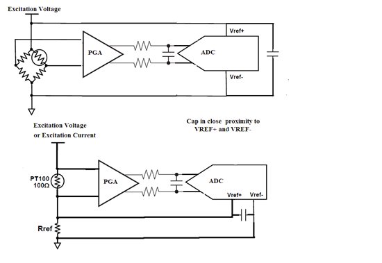

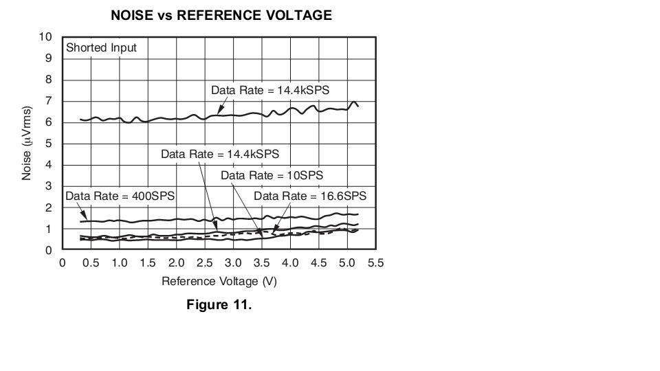

1.  I have attached the following graphic from the ADS1259 datasheet tat shows it has 2 noise specs (~ 1uVrms and 6uVrms) for the 14.4Kbps datarate. Is this correct or a typo?
2.  Also, how do i configure the ADC for use in a ratio-metric application as this is the most precise mode of operation for all output data rates?
3.  When is the appropriate time to de-assert the START pin low? Is it after /DRDY is low or some other time?

    The correct noise specs can be found on the Table 1 page 13.  Using a Data Rate of 14400 SPS and 2.5V reference, the correct input referred noise is 6.2uV RMS.  On Figure 11 on your post above, the 14,4 kSPS top label is correct; showing ~6.2 uV RMS; the bottom 14.4kSPS label is a typo.  It should read Data Rate=60 SPS, showing noise of ~0.7uV RMS.  Thank you for the feedback.
    Depending on the sensor type that is generating the input signal for the analog to digital converter, the device may be set up on a ratiometric configuration, where the source used for excitation for the sensor is also is used to generate the reference voltage.  The benefit of using a ratiometric measurement is that the drift and some of the noise of the excitation source is seen both at the input signal path and the reference signal path of the Analog to digital converter.  In this manner, the errors due to temperature drift of the excitation source and some of the noise of the excitation tends to cancel.  Two typical block diagrams are shown below.  The designer must account for the allowed differential and common mode voltage range of the PGA amplifier and the valid input voltage range of the ADC VREF inputs. In the case where RREF reference resistor is used to generate the reference voltage; the reference resistor must be in close proximity to the VREF inputs and must be a low drift, high precision resistor.
