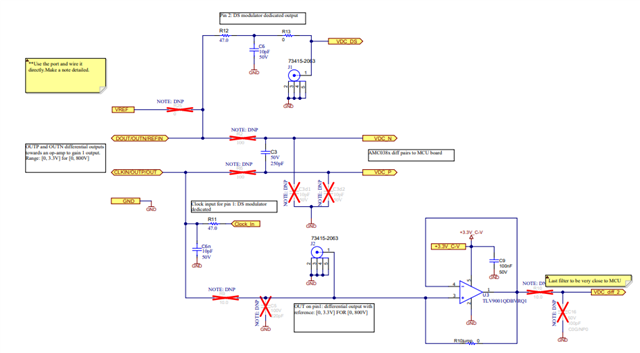

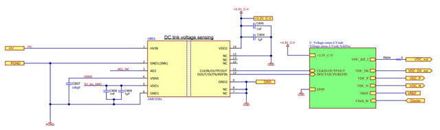

In the datasheet of the AMC0386 Q1 output is specified as digital. However, in the TIDM-02014 reference design (ASIL-D, 300 kW, 800 V traction inverter), this output appears to be connected directly as an analog input. Could you please clarify this discrepancy?
