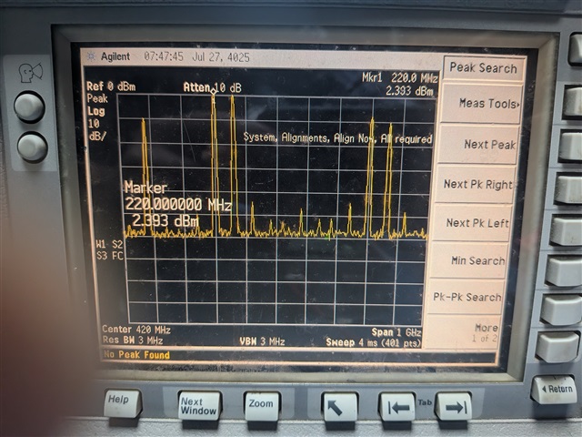

With these settings I am able to observe the sync and ready signals are toggling. I have verified
all the registers mentioned in the datasheet under " Initialization Set up" section. Is there any register
that needs to be configured or any other setting that needs to be considered to establish a stable link ?
P. Anirudh Reddy

  • Hi Rob,
    The sync toggling issue has been resolved when I changed the register 0x49 to 0x0000 which is the JESD link configuration setting.
    Now to check the DAC output, I am configuring the NCO to generate the 280 MHz signal which is given as one of the inputs to the mixer and giving a constant signal like 7F7F7F7F as another input to the mixer. The corresponding registers to enable the mixer, NCO and Frequency control word are written. The sampling rate, clocks and other parameters are same as mentioned above i.e. they are:
         sampling rate = 500 MHz,
          linerate = 5 GSPS,
          DACCLK = 500 MHz,
         JESD Ref clk = 125 MHz,
         SYSREF = 1.953125 MHz,
         LMFS = 8411,
         K = 32
    I can observe the output as 220 MHz due to aliasing. I can also observe the image frequencies.

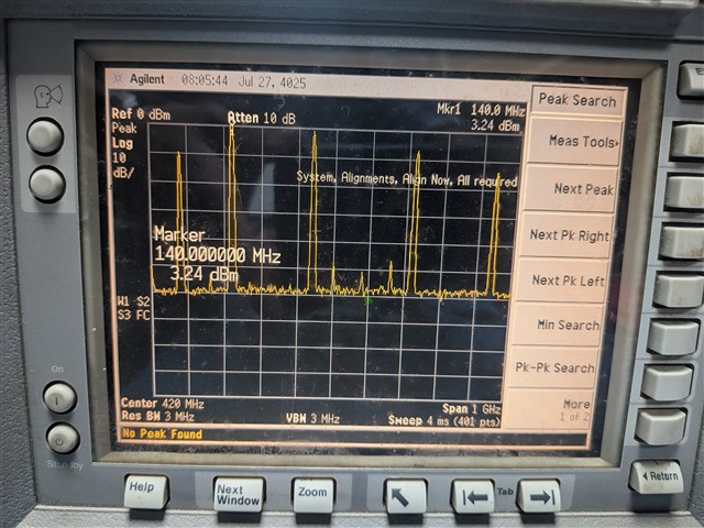

    When I try to enable the 2x interpolation, I can see the output as 140 MHz. I am enabling the 2x interpolation by writing the 0x00 register with data 0x011C. Generally when 2x interpolation is enabled, the sampling rate will be doubled and I need to get the output as 280 MHz. But this is not the case with my output.
    Am I missing any register or will there be any change in the DAC input rate and DACCLK when interpolation is enabled such that I can get the desired output.
    P. Anirudh Reddy
  • Hey Anirudh,
    Are you also doubling the clock rate of the DAC when you change the interpolation to 2x? Interpolation is what determines the rate between the input data and the output data. So simply increasing the interpolation from 1x to 2x will just cause the input rate to be halved. Typically changing the interpolation also requires adjusting the SERDES settings as the input rate changes with interpolation.
    Matt
  • Hi Matthew,
    After doubling my DACCLK (input data rate) to 1000 MHz, I am able to get the correct output of 280 MHz.
