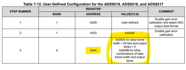

Question for Register "INIT_1"
On the register map (p.38), the description explain to Write 1011b during the initialization sequence. Write 0000b for normal operation.
However, on Table 7-12, it states to write 0x0000 for data frame width = 24bits, and 0x000B for other combination.
Which configuration is true for Register "INIT_1"?
    This register was part of the pre-release initiation sequence for these devices, but in latest release of devices in this family the initialization sequence was updated and mostly removed. However, for the 5MSPS version of these devices (ADS92x7) this register will still need to be configured according to Table 7-7 in the datasheet.
    For the ADS92x9 and ADS92x8 devices (10MSPS & 20MSPS) it should always be left in default configuration (0x0000).
    This is why it has the naming remains this way and it is still part of the device configuration requirements.
    For the ADS9219 please proceed with INIT_1 = 0x0000 or disregard writing to it at all. If using ADS9217 please look at Table 7-7 for correct configuration.

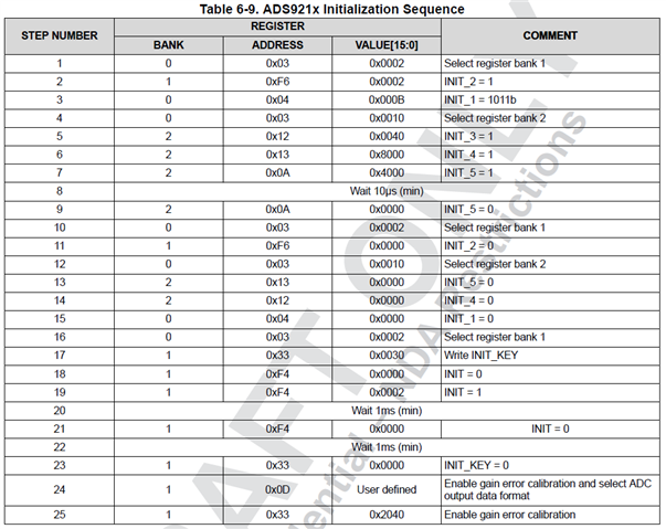

  • Hello Yolanda-san,
    Thank you for the detailed answer!
    Customer has both PASD9219 and ADS9219 in their hands.
    I believe the datasheet Rev.B is for PADS9219 and Rev.C for ADS9219. correct?
    Should they have different register settings for PADS9219 and ADS9219?

  • Great question Kuwahara-san
    thank you for letting me know they also have the PADS9219 version as well
    For the PADS9219 and any of the pre RTM version of the devices we had a separate initialization sequence  where that INIT_1 register was set to the 0x000B, configured, then the register would be set back to 0x0.
    These are the steps that should be taken for a PADS9219
    Please follow the ones on the current datasheet for the ADS9219 version
    If needed, we can also trace back the specific lot the devices came from and confirm further, in cases the customer has any issues.
