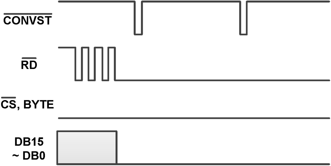

  • Hi Samiha,
    During my experiment, I found some corrupted portions in the stored data, so I drew the shape of the input signal I applied as shown below. I apologize for not being able to share the experimental data itself. The logical high level is 3.3 V and the low level is 0 V.
    For the /CONVST signal, I followed the datasheet specification, setting the pulse width between 40 ns and 400 ns, and I also tried applying it with the recommended transition time from the datasheet in case transition speed was an issue. The /CS and BYTE signals were tied to 0 V (logical low) after the IC chip booting. Since there was no specific requirement stated for the /RD signal timing, I tried both narrow and wide pulse widths, but the 16 output pins still remained at 0 without any change.
    I would greatly appreciate it if you could provide detailed waveforms showing how these control pins should be applied.
    Additionally, I would like to ask whether you provide an evaluation board for the ADS8371 device.
    Thank you very much.
    Kihun Kim
  • Hi Kihun,
    I understand. Unfortunately, we do not have an EVM for this device. This is an older part and my main reference material is the datasheet, so this will be difficult to debug. If you are not absolutely needing the parallel interface, I would highly recommend looking into the ADS8861 ADC instead. This is newer and the 18-bit variant has an EVM and software GUI available for your easy evaluation.
    Samiha
