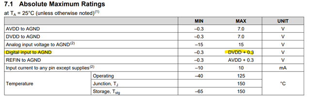

The board under development has a battery backup function.
During backup, the digital power supply (3.3V) will remain active, but the analog power supply will be turned off.
If the ADC only receives digital power (SPI, etc. will also be active) and analog power is not supplied, will there be any problems with the device?
There is a possibility that an analog signal will be input.
I appreciate your great help in advance.

    Thanks for your question. This should be okay, as the digital input is only dependent on the DVDD rail. Please note, no input signals may be applied while AVDD is powered down though. If an analog input signal is applied while AVDD is powered down, this may cause damage to the device.
    However, I would recommend issuing a reset after the supplies are both powered up to ensure proper operation, per the power supply section in the datasheet:

    According to the absolute maximum rating, analog input voltage to AGND is -15V to +15V.
    I think this means analog input is acceptable when AVDD is turned off.
    Are there any other reasons why this is unacceptable?

    I confirmed with the team and you are correct! You may apply up to +/-15V to the analog inputs while AVDD is powered down.
