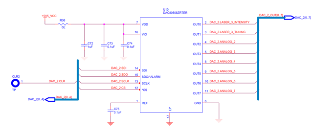

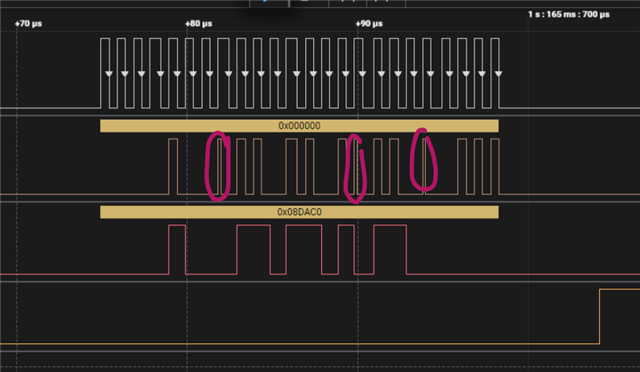

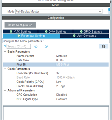

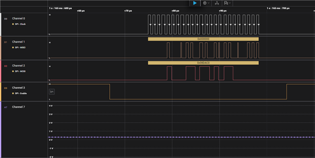

Hey i am using the DAC80508ZRTER IC and the output that I am getting is inconsistent : It works when I am outputting a constant value, but when I am trying to output a ramp or a sinusoidal wave it either tends to stay at a constant value or random values and on rare ocassions it gives the right signal. The schematic , code ,SPI configuration and signal output is attached with this post. Another doubt that I have is, while writing what is SDO supposed to output? because at the moment I am getting random values.

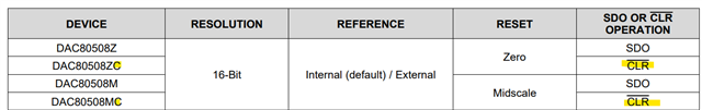

    SDO will either echo the last write command or return the requested data if the last command was a read command. What is the part number you actually have populated on the board? I notice you have a CLR test point. The part numbers that include the letter C have a CLR pin instead of an SDO pin. In that case the pin is a clear input rather than an SDO output.
    Can you also look at the analog view of the SPI write? Would be useful to see what these jumps are:
    What is the logic level of your SPI signals?
    Have you sent any other configuration settings to the DAC? Or after a power cycle are you just writing to the DAC output register?
