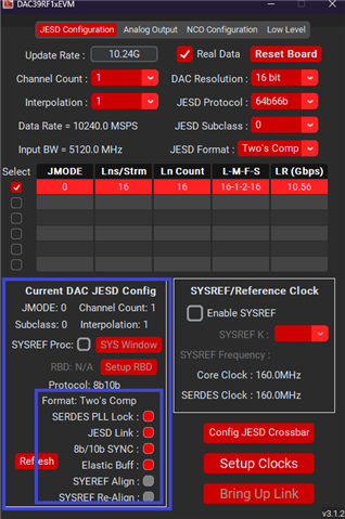

I am currently working with the DAC39RF12EVM board connected to the TSW14J59EVM board, and I followed the procedure in the User Guide to download and run the program. However, I have encountered several issues and would like to ask for your advice.
At the initial execution stage, the JESD Config status indicator does not turn green as shown in the User Guide figures.
Ignoring this, I proceeded with the User Guide steps and set JMODE0, but the expected 4 GHz single tone output was not observed on the spectrum analyzer. Even after completing all of the settings, the JESD Config status indicator still does not turn green.

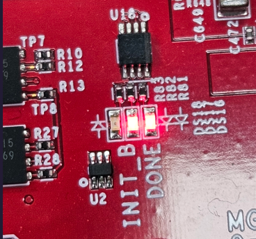

In addition, the LED status on the TSW14J59 board changed as shown in the attached photo, and I am not sure if this indicates normal operation.
Finally, after Figure 2-7 in the User Guide, is there any additional button or step that I need to execute?
For reference, I have also attached the j59 server log. Please let me know if I am missing any procedure or if my configuration is incorrect. I would also appreciate clarification on whether any separate jumper settings on the TSW14J59EVM board are required.
