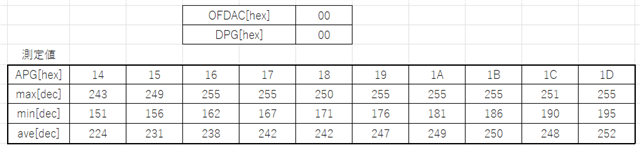

  • Hi Karthik,
    (2) Regarding the saturation code vs. APG:
    Apologies for the confusion. In my first message I mentioned that changing APG does not affect the saturation code, but after further testing I found that is not the case.
    The measured results of how the saturation code depends on APG are as follows:

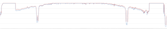

  • Hi Mori,
    (2) In the below table, for APG = 0x14, the max code of dec 243 is saturation voltage or just max voltage? Can you share digital output curve for this use case?
    This is not expected. I am suspecting that TCD1209DG output is saturated.
    Can you double the exposure/light power and see if there is any change in VSP digital output? If there is no change in VSP digital output, then it would indicate that the CCD sensor is saturated.
