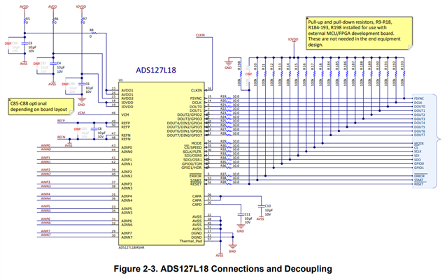

I am currently designing using the ADS127L18EVM circuit as a reference.
(1) In the ADS127L18 EVM, Figure 2-3 below shows the 10Ω resistors R19 to R39.
What are the purposes of the 100kΩ resistors R9 to R18, R184 to R193, and R198?
(2) In our case, the output of the ADS127L18 will be connected directly to the FPGA.
At this time, I'm connecting directly to the FPGA, so I understand that removing the 10Ω and 100kΩ resistors is not a problem.
Is this understanding correct?
