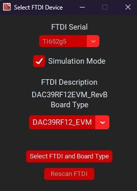

I am currently using the DAC39RF12EVM board connected to the TSW14J59EVM board with the TI GUI.
According to the User Guide, I have verified the power supply, jumper settings, and clock input, and the GUI correctly displays both the FPGA number and the DAC board type.
However, unless I check the Simulation Mode option, the GUI does not proceed to the next step.
Even though the actual board is connected, it seems that I must enable this mode to continue, and I would like to know if this behavior is expected.
If there are any additional steps I should take—such as installing a required USB driver or changing jumper settings on the TSW14J59EVM board—please advise.

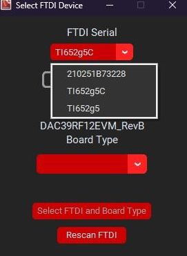

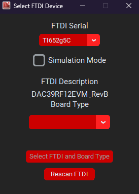

  • Kim,
    Could you try disconnecting the EVM from the PC, reconnecting it and then waiting about 10 seconds? Sometimes the FTDI driver misbehaves. The fact that two serial numbers are showing up that are identical and one ends with C indicates the FTDI driver may of had a hick-up.
    Matt
  • Hello
    I tried disconnecting and reconnecting the EVM as you suggested, but the issue still persists.
    I also tested it on a different PC, and the same behavior occurs there as well.
    For additional context, I am also using an ADC12DJ5200RFEVM. To my understanding, its GUI also communicates over FTDI, and I have not observed any connectivity issues when using the ADC board.
    I have also performed a clean reinstall of the FTDI driver (removed existing drivers and installed the current Windows driver installer), but the behavior did not change.
    Do you have a recommended FTDI VCP/D2XX driver version for this EVM/GUI? If not, are there any other steps you would suggest?
