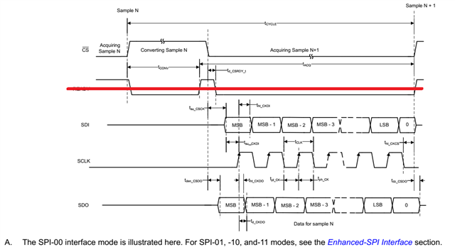

2. SPI-00 Protocol Timing Behavior
Regarding the SPI-00 protocol (default), our understanding is:
  • SDI is latched on SCLK rising edge
  • SDO updates on SCLK falling edge

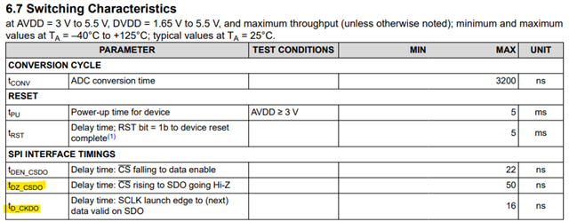

Additionally, we would appreciate your clarification on:
  • Page 9 of the datasheet (Figure 6-3) appears to imply:
    • SDO becomes valid after CS falling edge + tDEN_CSDO
    • SDO toggles after SCLK rising edge + tD_CKDO
  • However, we could not find explicit timing definitions for tDEN_CSDO or tD_CKDO in the electrical characteristics table.
Do you have more detailed SPI timing charts (such as SCLK / SDI / SDO waveform diagrams), especially for Daisy Chain mode in SPI-00, that you could share?

  • Hello Connor,
    To answer your questions:
    1. Yes, the FPGA will receive the data from the last ADC to 1st ADC order: FPGA<--ADC4<--ADC3<--ADC2<--ADC1<--ADC0
    2. I can recreate a timing diagram for the ADS7066 specifically but the one shared could work very well for SPI-00 w/enhanced SPI for the ADS7066
      1. Figure 6-1, 6-2, and 7-5 in the datasheet show this but separately
      2.  tDEN_CSDO has a max limit of 22ns and  tD_CKDO has a max limit of 16ns (these values can be found in the 6.7 Switching Characteristics Table in the datasheet
      3. Figures 7-5 shows the SPI-00 protocol SCLK/SDO relationship as well.

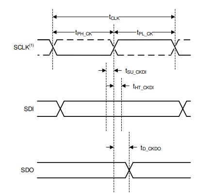

  • Hi Yolanda,
    I understand the timing of when data is output to SDO as follows. Is this correct?
    • First, CS falls: SDO is enabled.
    • Next, SCLK rises: The next data is output and SDO is updated.
    • Next, SCLK falls: SDO is updated.
    In this case, is it correct to understand that SDO is updated on both the rising and falling edges of the first SCLK cycle?
    Conor
  • Hi Yolanda,
    Conor
  • Hello Connor,
    So this device works with an "enhanced-SPI", it works as SPI but its timing is able to be a bit faster to enable full throughput with slower SCLKs
    What happens with this device is:
    • First, CS Falls - SDO is enabled
    • Next SCLK Rising Edge - SDI is latched and SDO is valid
      • there is a small delay of tD_CKDO, then SDO updates.
    • Next SCLK Falling Edge - SDO "updates"
      • tD_CKDO is the time from the "Launching" edge (in this case same as the SDI Latching edge) to when the SDO actually updates
      • Because this is after the the edge that is used to read SDO, the updating edge is "rounded" to the next edge --> the falling edge.
      • This SDO is essentially updating t_CLK/2 - tD_CKDO before the falling edge (or t_PH_CLK - tD_CKDO).
    The SDO only updates once per SCLK period, because of the enhanced SPI it is earlier/quicker than typical SPI protocols.
    Yolanda

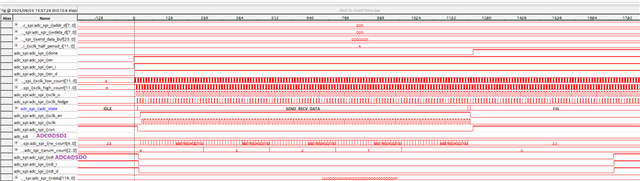

    We would like to confirm one more point regarding the SDO update timing under SPI-00 mode.
    To summarize our current understanding:
    The SDO output is updated beginning at the rising edge of SCLK, and after a delay of tD_CKDO (MAX = 16 ns), the data becomes valid.
    If the tD_CKDO minimum is 0 ns, then it would appear that the SDO is updated directly at the rising edge of SCLK.
    Based on this, we understand that the SDO is updated only once per clock cycle.
    Is it therefore correct to interpret that under SPI-00 mode, the SDO is effectively updated on the falling edge of each SCLK (as this is the time at which it is typically read)?
    We have also created a timing diagram (attached) showing our understanding of the CS/SCLK/SDI/SDO timing for SPI-00 mode during Daisy-Chain communication.
    Could you please review this diagram and let us know if there are any mistakes or misunderstandings?
    ADC SPI_daisy chain timing.xlsx
    Despite testing various timing configurations, the SDO output timing of the first ADC in the chain (ADC0) still appears incorrect, and we have not yet succeeded in establishing full Daisy-Chain operation with 5 devices.
    If Daisy-Chain communication cannot be made to work with our current setup, we may need to consider a circuit redesign.
    In this regard, we kindly ask the following questions:
    Has the ADS7066IYBHT Daisy-Chain mode been successfully verified on actual hardware in your lab or with a reference design?
    If available, could you share any example code (even in C language) that demonstrates how to operate the ADS7066 in Daisy-Chain mode?
    We appreciate your assistance and look forward to your feedback.

    2. Data frame configuration
    The data frame configuration is set to default. The SPI protocol is also default (SPI-00).
    3. Register readback and NOP test
    To perform a register readback, we understand that the read command (0001 0000b), an 8-bit register address, and 8-bit dummy data must be sent. However, since daisy chain communication with the ADCs is not functioning, we have not been able to complete a readback.
    When only NOP (0x000000) is sent, the returned value from the ADCs is 0. Please see the attached image for reference.
    4. Schematic
    We will send the schematic of the ADC daisy chain connection via private message, so please approve access.
    Conor
